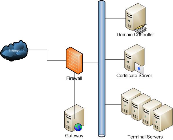

This is the picture of what I'm doing now,
at the moment I'm inside the local network and would like to publish the Web Server 2008 which is located same in the DMZ is it correct that i should
1. publish the TSG.domain.com through the world using port 443

@albertwt: Aren't you missing a terminal server from your picture?
I've not had chance to play with Terminal Services Gateway, but if it works like Citrix Secure Gateway you would have your gateway in the DMZ and this then brokers a secure connection to a terminal server that is on your network.
The idea of the gateway server is to publish your terminal server on the web via SSL using only port 443. Meanwhile, your server still has access to your LAN.
You may find Remote Desktop Services (Terminal Services) Team Blog : RD Gateway deployment in a perimeter network & Firewall rules useful.
I have also attached a simple view of my setup.
