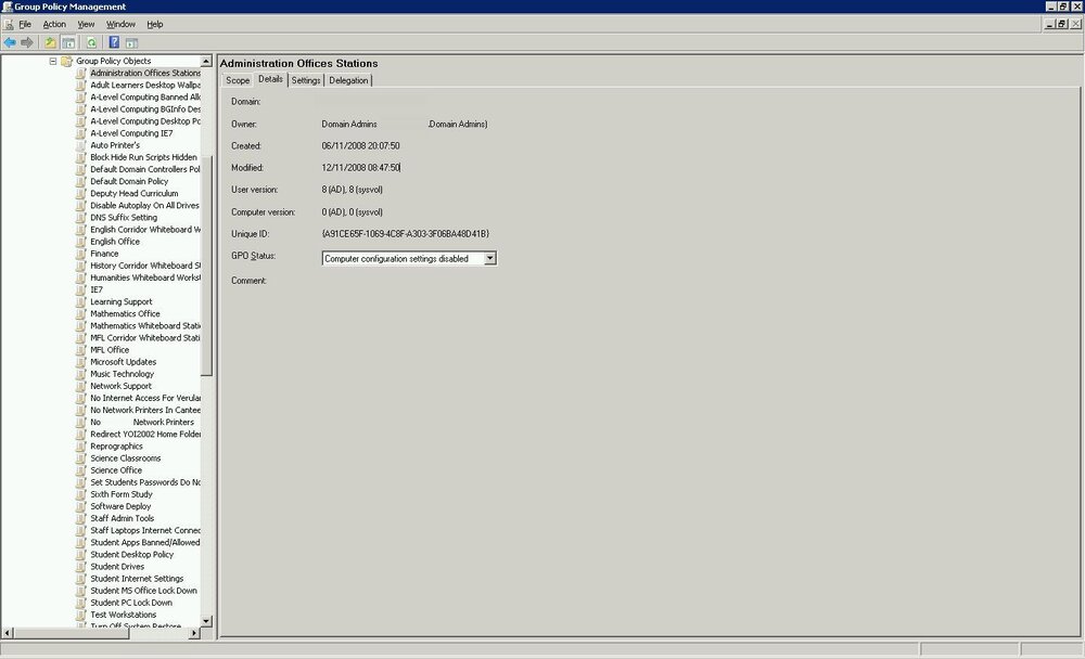

I have a problem with Group Policy preventing a newly installed program running [incidentally I also have a similar issie with Group Policy preventing Windows Movie maker running but that is for another day]
I have attached two JPEGs: 'Read And Write GP Error.jpg' and 'Group Policy Rule Search.jpg'
Read And Write GP Error.jpg shows the event log entry for when the program is prevented from running. Looking for the group Policy Rule {cd760750-a653-443b-b3df-421072fdbd3c} through the whole of my domain yields zero results [no hits] looking for the same Group Policy troughout the whole of the domain [my domain is a child domain in a parent domain] also yields no results. My questions here are:
1. Where can I find this Group policy which is preventing 'Read And Write 9' from running?
2. Once I have eyes on the policy what changes do I make to it to allow the program to run? [it may be a risky strategem to just delete it]
BTW: I have already added a path rule which (should) allow 'Read And Write 9' to run for students. 'Read And Write 9' runs for the domain administrator. I do not see any point in addressing any issues with this program for staff at the moment because they are in the parent domain and have different policies controlling their activities.

@jmcdermott: Thanks for that. I have not been able to track down the problem with 'Read And Write 9' though. I cannot find the restriction policy which is preventing this program from running. I am just about to reconfirm all of the settings and do a GPUpdate /force to see if that makes any difference.
[interestingly I DID find the problem with Windows Movie Maker: The reason I had not found it before was that in Group Policy and it says that it requres at least Vista: We are running XP and although it had been set by an engineer from a company assisting us I had assumed that it had no effect due to us running XP Pro at the client stations?]
I have the answer now: The program [Read&Write 9.exe] runs. When it had completed all of the preparations it calls another exe [RW9.exe] in a sub folder under the main Read And Write folder. It is RW9.exe which was prevented from running [This was by no means clear from the error messages though]
Nevertheless it is good to have found the answer [Many thanks to Texthelp Systems Limited Helpdesk]
