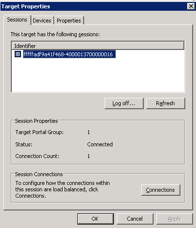

Seems to be more the iSCSI initiator doing it, if I go onto Targets > Details > Properties it shows 2 "Associated Network Portal Groups" - one for each NIC.
Normally in session properties there's 1 connection and 1 session (the 172.16 iSCSI NIC).
When I pull that cable out it plucks the other NIC out the air and then decides to reconnect with the 2nd connection... great for failover but without knowing that's happened the traffic goes over the main network :rolleyes:

Funny enough I'd just hit that link earlier when looking through the web for a solution! Multi path box left unticked in the setup.
Just attached where it lists the 192 address, IPs are usually full but blanked out for obvious reasons.
When the cable gets unplugged the iSCSI reconnects and where it's usually Target Portal Group: 1 it then becomes 2 and connects via the main network NIC...
(see attached pics)
