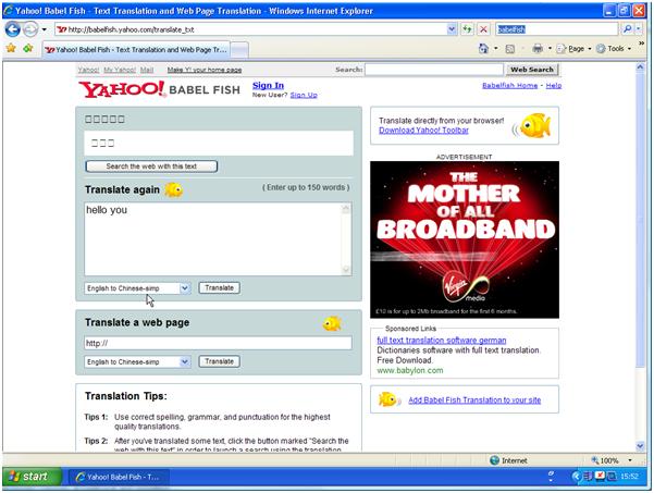

One of the teachers within my school wants to use Babelfish as it has Chinese and Korean translations. The problem is it doesn't display the Chinese and Korean characters, it just displays squares! (please see attachment) Bablefish works ok with other languages just not those that uses symbols instead of abc etc. Do I have to install the Chinese and Korean languages or something? I'm using XP on these machines.

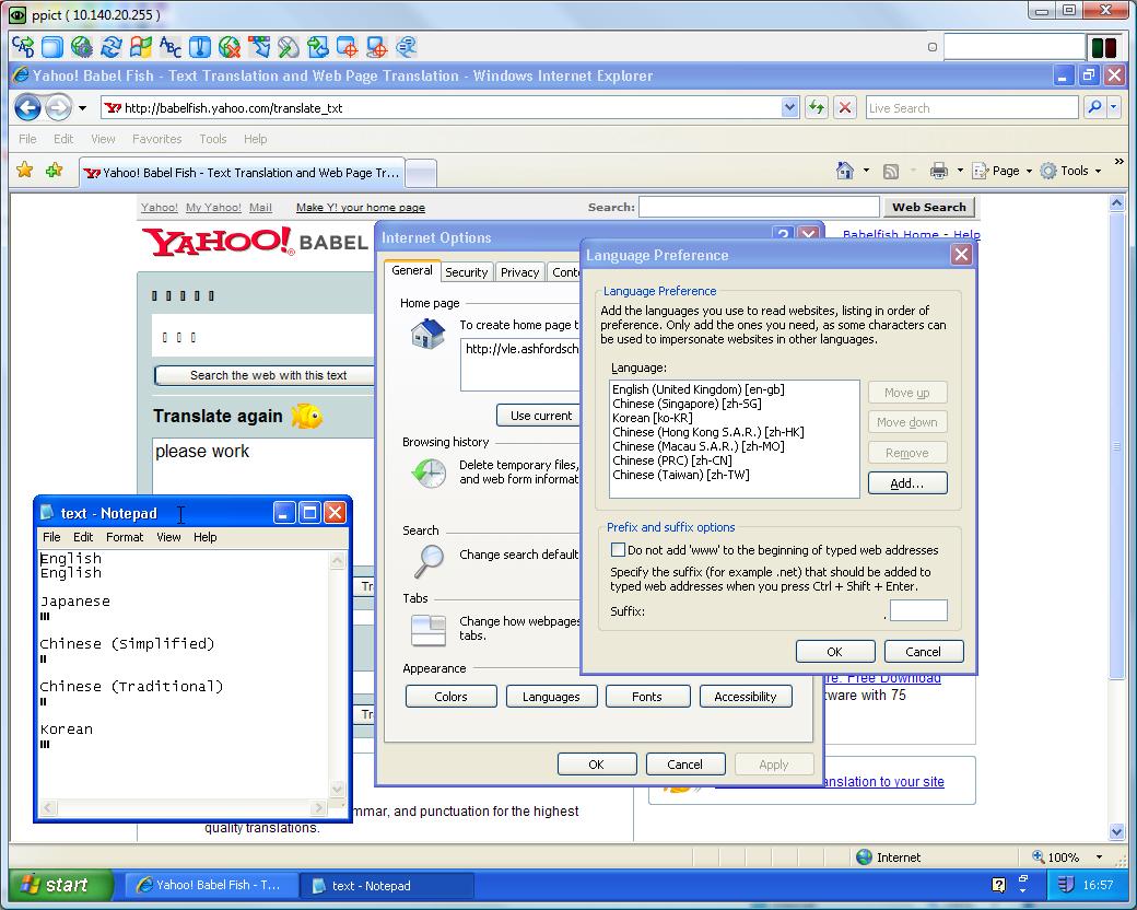

Hmm Weirdness, is the page in the right encoding? (Right click the page, or view menu in Internet Explorer -> Encoding -> Japanese (Auto) if showing Japanese) failing that, I can't think of much more.
If you want to test that your fonts installed correctly, you can download the attached test document which I've prepared that lets you see if you can render Chinese, Japanese and Korean, if you've got problems reading this, then theres a problem with your Language installation, if not then it's probably something else.

Thanks for the replies people still having no luck though :mad: even added the languages to internet explorer settings.... can't understand what I'm missing.
Plus your txt file doesn't display correctly on the PC so something is missing, it's ok on my PC though :eek:
