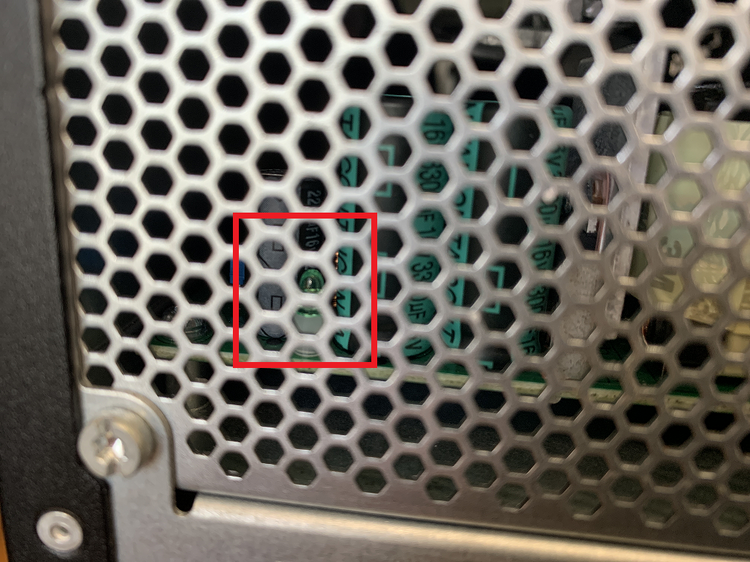

However, I did a bit more digging and found the higher spec models have BIST on the back I/O panel, unfortunately the Z440 doesn't but I did notice an LED inside of the PSU itself. Now this doesn't light up on either of the PSUs when plugged in to a socket....
So my question is, does anyone know if this should light up when the PSU is receiving power, or only when turning the PC on?
