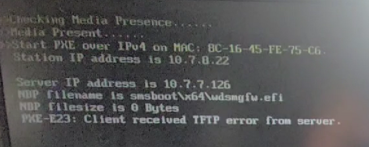

Error message from video:
Looks like you need to investigate the error code PXE-E23.
From a quick google, some fixes that have apparently worked for people:
  • Rebooting the server to restart all services has fixed this for some people
  • Create/distibute/use a new boot image
  •  'Deploy this boot image from the PXE-enabled distribution point' not being selected
  • Removal of PXE from the DP and adding back
  • Redistributing the boot image you're using
  • Something worth taking a quick look at is administration -> overview -> distribution points; properties; general tab: create self signed certificate or import....
  • Might be worth checking the servers pxe log:  (Drive letter)\Program Files\Microsoft Configuration Manager\Logs\SMSPXE.log
Hopefully something helpful in the above?
