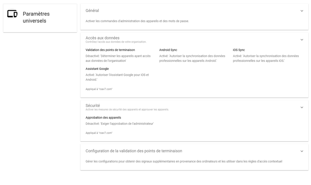

MaelLemarchand Posted April 24, 2025 Author Posted April 24, 2025 Thank you for your reply, I confirm that Windows management is enabled. I have already tried in 4G and by disabling Windows Defender and the same. I also saw this page, is it configured well in your opinion (if you understand French) ? I'll try to see with a google ticket at the same time.
