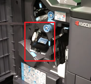

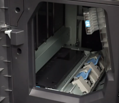

Anyway, there are 2 places for staples... at the bottom of the booklet finisher there are two sets of staple cartridges... we have those, they are slightly smaller and are KYOCERA 1903JY0000 - SH10.
However, there is another place for staples about half way up (the larger cartridge), but I don't know what they are as there's no real markings.
Does anybody have these, who are a little more organised with their consumables and know what they are SH-12 or SH-14 maybe...?

1 hour ago, mark100 said:
We have a few of these and would fit SH-12s in that slot.
Think it looks like Sh-12 as well, staples we have are SH-10 (same as SK-602) and MS10A which have the paper/card tab you pull to release
