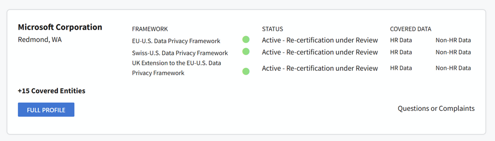

As you said originally EU-US shield, that was dropped, then re-stuck with the new UK extensions as they added US back to the list (https://www.gov.uk/government/publications/uk-us-data-bridge-supporting-documents/uk-us-data-bridge-factsheet-for-uk-organisations)
From 12 October 2023, businesses in the UK can start to transfer personal data to US organisations certified to the “UK Extension to the EU-US Data Privacy Framework” (UK Extension) under Article 45 of the UK General Data Protection Regulation (GDPR) without the need for further safeguards such as those set out in Articles 46 and 49 of the UK GDPR
But it still relies on an opt-in from US side of things so isn't as clear cut in terms of UK hosting.
Might want to do a quick search under the DPF if those other two companies are listed: https://www.dataprivacyframework.gov/s/participant-search https://www.dataprivacyframework.gov/list as that would give you the quickest answer to if that's even an option under those guidelines. As an example from above for Microsoft:

Thanks for this. Funnily enough one of the 2 overseas companies has just notified us of their presence on the DPF list. I checked and they are indeed there! I suspect our DPO is not quite up to date. Could you expand on you comment about opt-in on US site - do you mean they have if they are on the DPF list? I was a little confused by the 'UK hosting' comment.
I just mean that not all US firms are automatically covered even with the extension ruling. They need to opt in via the DPF platforms etc unlike companies in UK where they have no choice but to comply with GPDR
