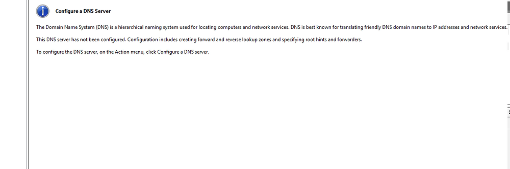

ramon82 Posted September 10, 2023 Report Posted September 10, 2023 Windows Server 2016 - DNS/AD problemHi all - at one point our DC froze and we had to do a restart. It installed a lot of updates and then once it got up and running again we started experiencing problems with DNS, passwords, mapped drives etc - please refer to screenshots. Its as if the communication between the desktops and the server got out of sync somehow.Any idea what we can do please?Thank you

chaplic Posted September 11, 2023 Report Posted September 11, 2023 I think we are seeing symptoms rather than the cause The DNS MMC screenshot is just empty, assuming we're on the DC it should be connecting to itself Some questions 1) Is the netlogon service running on the DC 2) is the DNS service running on the DC 3) what's the IP Addresss of the DC and what is the DNS client settings (it should be pointing to itself). What about a PC, does it have the DC set as a DNS server 4) from the dc do net view \\dcservername - is the netlogon share shown? can you do the same from a client
