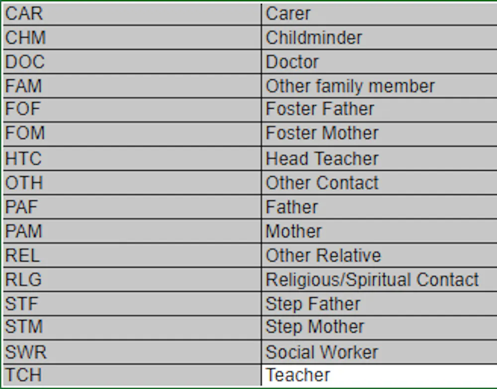

For C1 / C2 / C3 Relationship, you should be entering the codes found in the Main Gov CDBS, CodeSets tab rows 1232 to 1247.

Same applies for Language and Ethnicity codes. these should all be the coding shown in relevant section of CDBS CodeSets tab.
