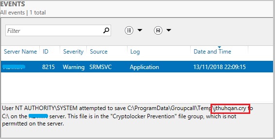

The worst part is the my server is emailing me saying that is has found files with the extension of .ecc and.kkk - well known cryptolocker virus extensions.... I have also had in the past...
Supposedly these are random file extensions but come on guys!!! And yes, I know... as their support said 'whitelist all the Groupcall things'... but I want to reduce the amount of directories that don't get virus checked not increase it! :doh:

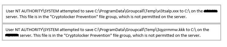

Two alerts I got over the weekend...
[ATTACH=CONFIG]69243[/ATTACH]
Do you think the Groupcall coders are secretly just having a laugh...?
It's been that way for years sadfully (example from 2018) - http://www.edugeek.net/forums/security/196320-groupcall-crypto-vulnerability-something-else.html#post1678329 - and basically confirmed as you said, that only way to avoid it would be bypassing the entire temp folder which isn't recommended.
The only other way I could think of doing it (while still a bodge, but less of a security risk) is scripting a Bypass rule to add to the FSRM service for that minute that the GroupCall process runs (assuming that alert is from around that 1am window it used to run?), and then removing it again after. So it's only activated on the temp folder for that minute or two it needs to process the file
