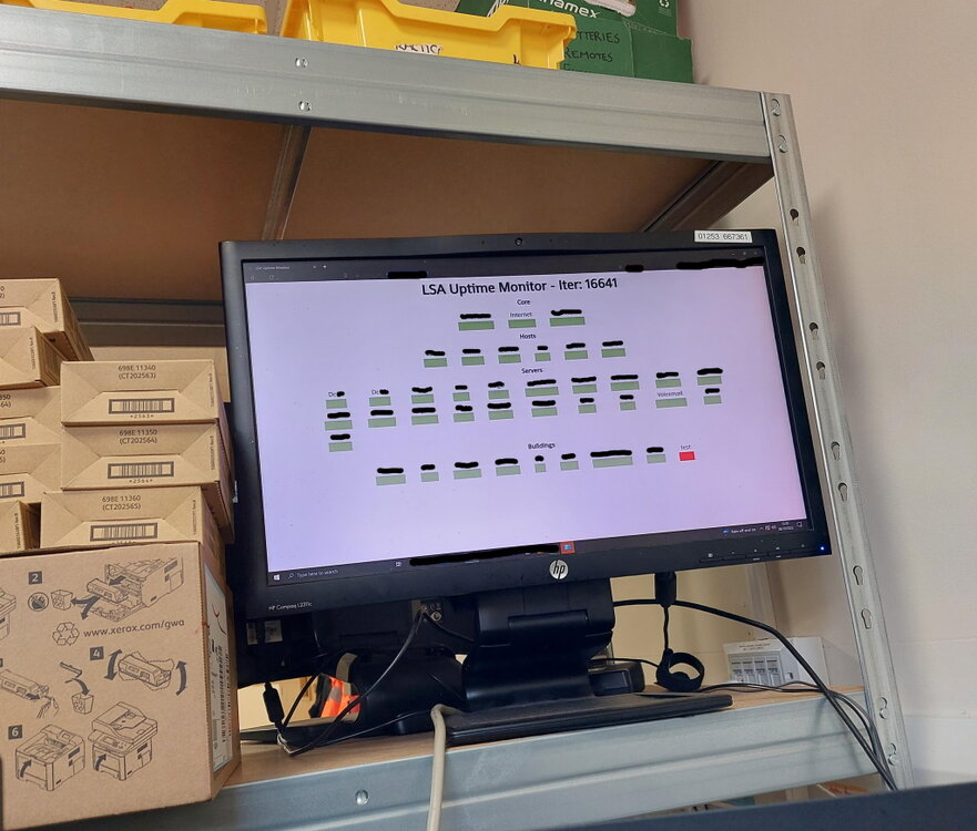

I wrote this because of having some issues and waiting for people to tell us there's a problem is less than ideal.
It uses Flask which can be installed with Pip. https://www.w3schools.com/python/python_pip.asp
If you have smoothwall, the pypi urls can be excluded from https inspection which stops certificate errors.
I run the script as a service on an ubuntu server plugged into the core switch. We also have port forwarding on smoothwall so it's accessible from outside. At the moment it displays on a pc/ monitor in our office but planning to get a smart tv on the wall instead. The script works equally well on windows server or 10.
You may wonder why it shows iterations on the page - the previous version that worked differently had an issue where it could stop working and you couldn't tell. The number represents every time the page is generated on the server so if the number is going up it's definitely working. It has a 10 second refresh which is specified in the html file.
It checks open ports of devices which you can find with nmap. On windows servers I'm using the rdp port 3389
This is what it looks like for us.
It will produce narrower tables on non windows devices aka mobiles.
