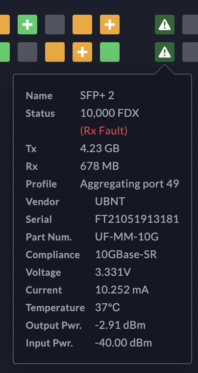

So the main switch that our router plugs into is disconnecting all the time (or so it says in the Unifi 'events'). I've looked and both SFP+ ports that are aggregated to another switch show 'RX Fault'. I looked at the ports on the other switch and there's no error.
I thought it might have something to do with polarity of the cables but nothing has been changed and it's only just started reporting an RX fault in the last month or so (been running for 6-7 months with no issue since then)
I'm also confused as shouldn't both switches be reporting an RX fault? I'd also presume that if any switch would disconnect from the network it would be our second switch as that uplinks to this switch... if that makes sense?

First Switch (Connects directly to router)

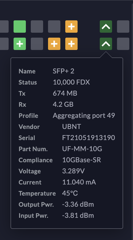

Second switch (Connects via SFP+ to first switch)
