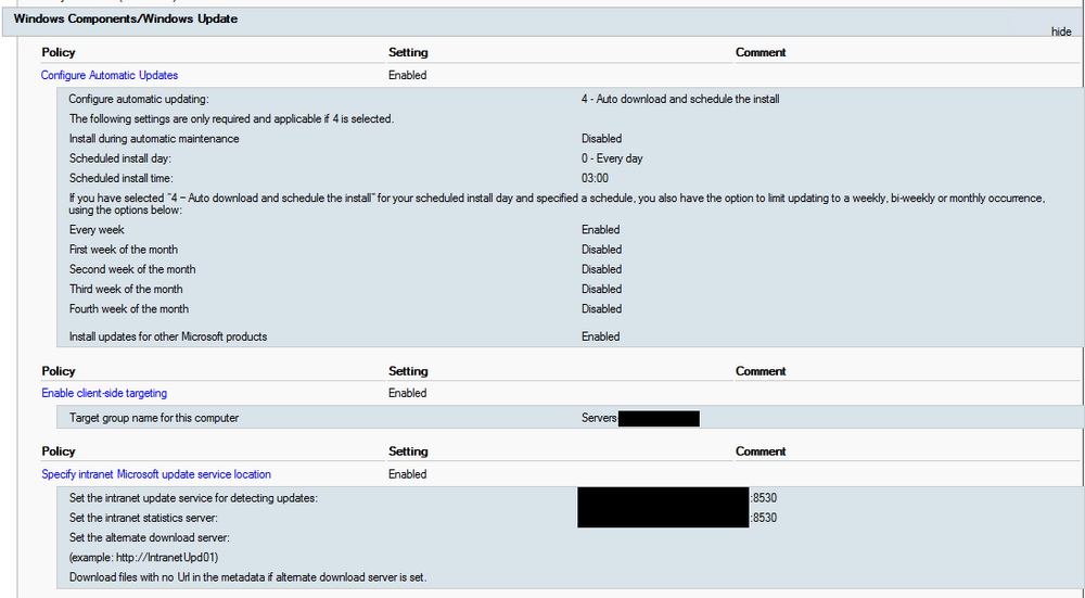

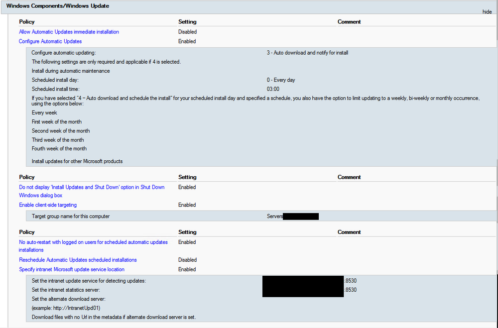

I'm using WSUS to auto install updates on public facing and lower priority servers. The critical stuff like domain controllers get their updates installed manually. These group policies work on 2012R2, 2016 and 2019 servers.
