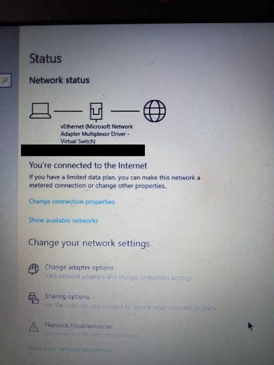

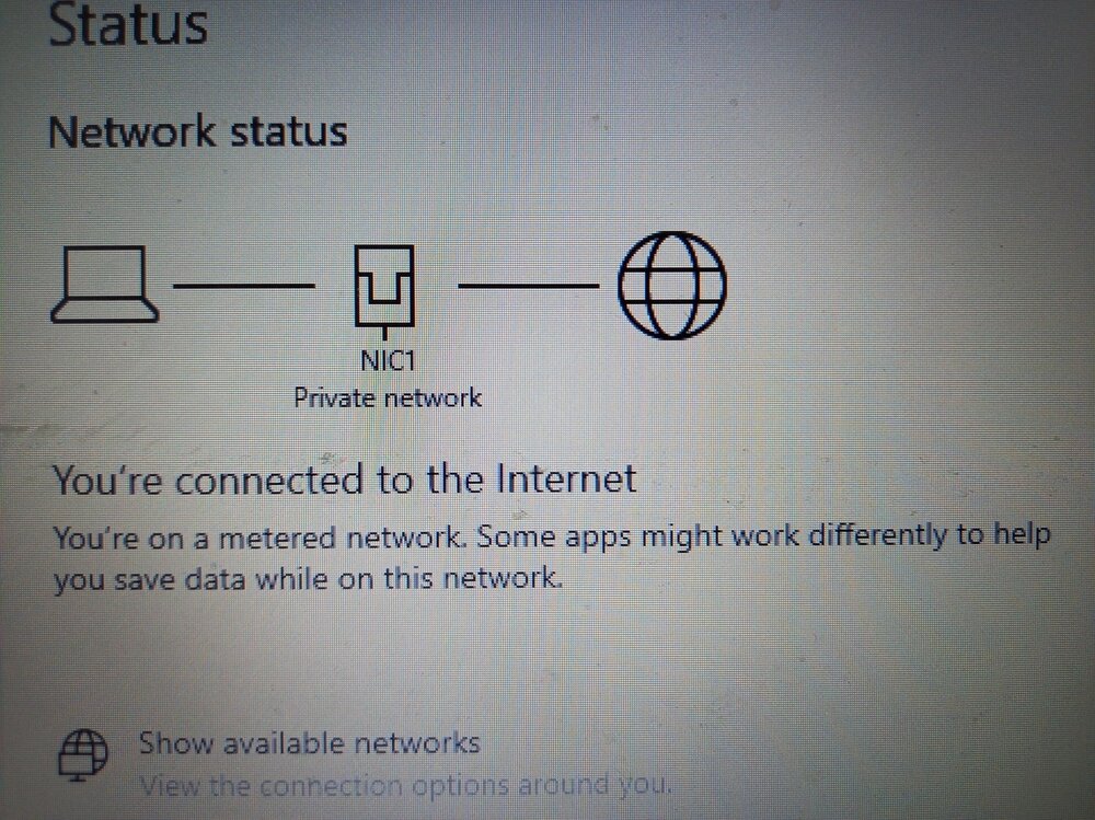

On the two images below.
In 2019 you would get this below :-
In 2022 it's this, same setup but using powershell to set the teamed nics as below :-

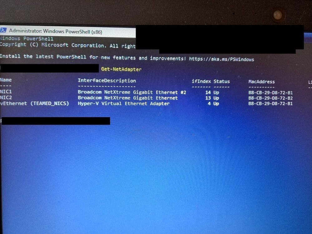

And here are the Nics :-
The DNS appears fine. No errors anywhere on the server or DNS tests or anything. All working fine.
The Nic Teaming on the Windows 2022 was done via powershell. SET is an alternative to the NIC teaming feature that Microsoft gave us way back in 2012. Windows Server 2012 and later required NIC teams to be created at the OS level, but you could bind a Hyper-V virtual switch to the NIC team, just as you can bind a virtual switch to any other physical network adapter. In contrast, SET lets you combine up to eight physical network adapters (the adapters have to be identical) into a Hyper-V virtual network adapter.
Switch embedded teams are switch-independent, meaning that the physical switches to which the teamed adapters are connected are unaware of the team's existence.

That shouldn’t be any different, we use SET in 2019 (was in 2016 server)
My point with the DNS side was the only time NLA changes profiles is when it detects the DNS Name response on the NIC and if it’s not a domain one it won’t set the domain profile in NLA (say for example the service starts up too slow)
But that’s even if it’s just 1 drop it’ll then cache that response until you restart
The reg key just tells it to keep trying until it finds a response as it’s always expecting a domain response from DC
