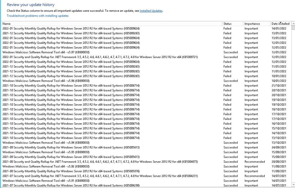

For some reason, every since the Printer Nightmare towards the end of last year, this particular server is refusing to install some updates.
You will see from the below, between October 21 and January, no updates were installed.
I have removed the server from the WSUS GPO so it now manually can download updates, it has managed to install a few starting on 10th Jan 2022 and then some more on 12th but continues not to be able to install:
KB5006714
KB5008263
KB5009624
Does anyone know why this would be?

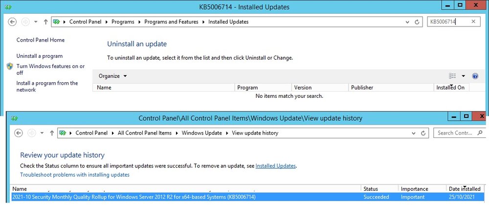

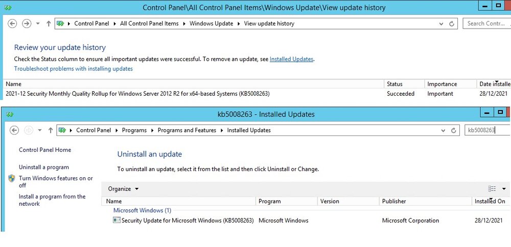

My Windows Update is being a bit strange as well as I can see KB5006714 in the installed updates history, but it isn't available in 'Installed Updates'... :confused:
KB5008263 is in both...

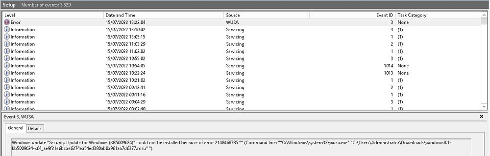

Thanks for your post and sorry for the long delay. I tried what you suggested several times and this was the result when installing the KB5009624 MSU:
And here is a view from Event Log:
I decided to extract the CAB from the MSU.
I ran it using DISM in elevated CMD.
As usual, error yet again:
DISM log attached to this post. dism.txt

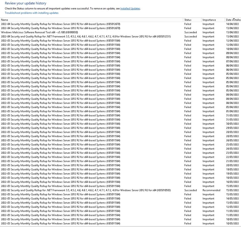

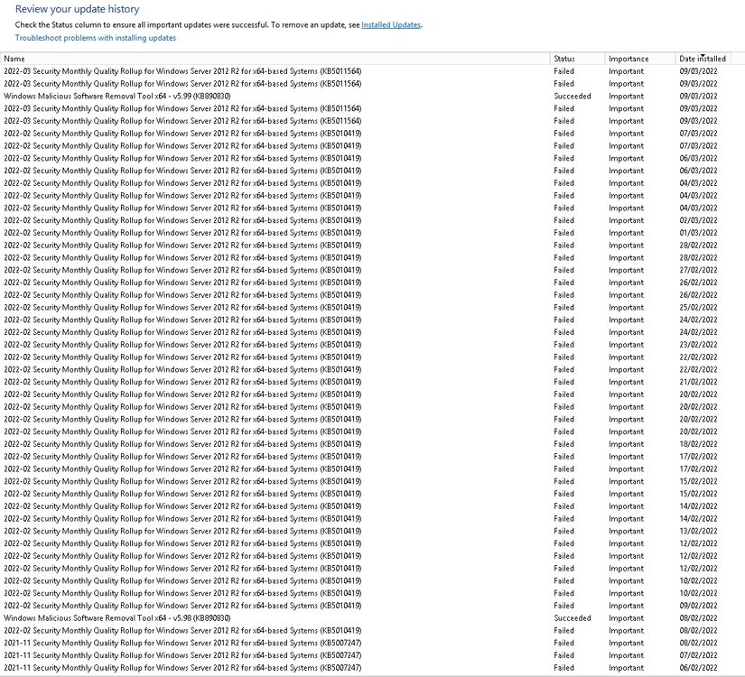

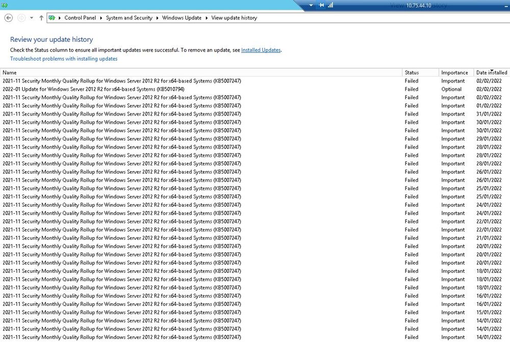

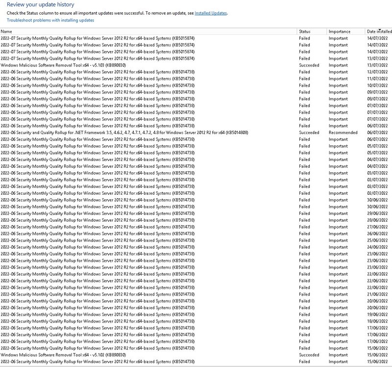

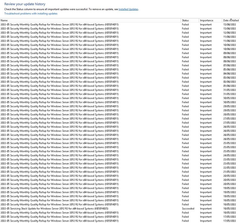

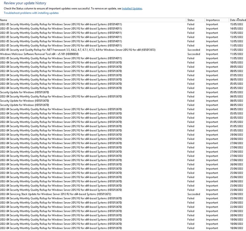

I have an extremely long list of failed updates in Windows Update History now which is very worrying. Can anyone advise? Win Server 2012 R2 Version 6.3 Build 9600.
FailedUpdates1.jpgFailedUpdates2.jpgFailedUpdates3.jpgFailedUpdates4.jpgFailedUpdates5.jpg

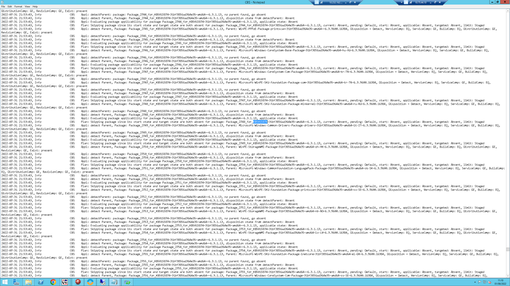

Look at CBS.log as this should give you the KB id of the update that's causing issues (possibly a missing prerequisite?)

Thanks for your post.
I did have a good look through the CBS log and I kept seeing the following:
So I downloaded the KB5015874 update but againwhen I manually installed, I get the following:
It doesn't seem to matter which update I try and manually install, they all fail.
