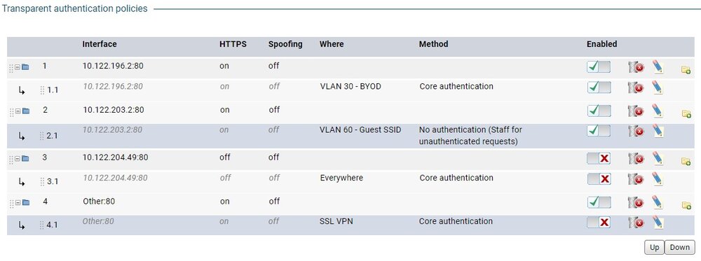

This is what we have for Transparent proxy:
The BYOD setup is working fine, but the Guest VLAN is not being filtered despite directing to a group for no auth and then having a rule in guardian for that location and group.

Turns out that the Transparent connection policy on the .49 address needed to be enabled and HTTPS filtering needed to be on.
