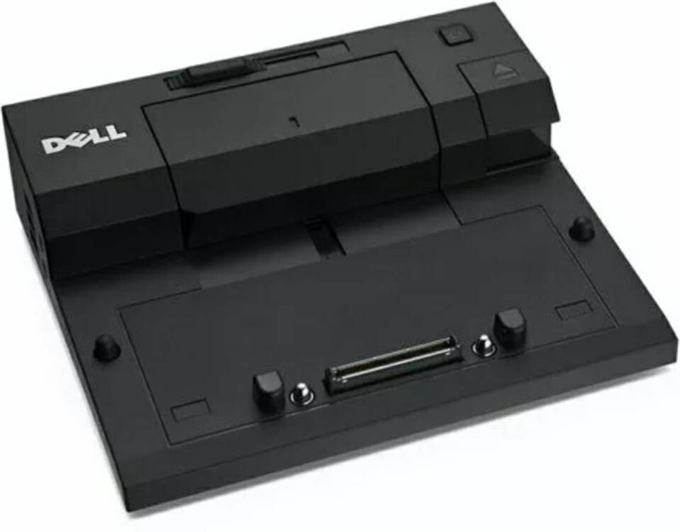

What model Dell are you using?
Do they have the E Dock connector on the bottom?
I've got loads of these if they are of use? Free to a good home I'd have to see how many but maybe got 30
