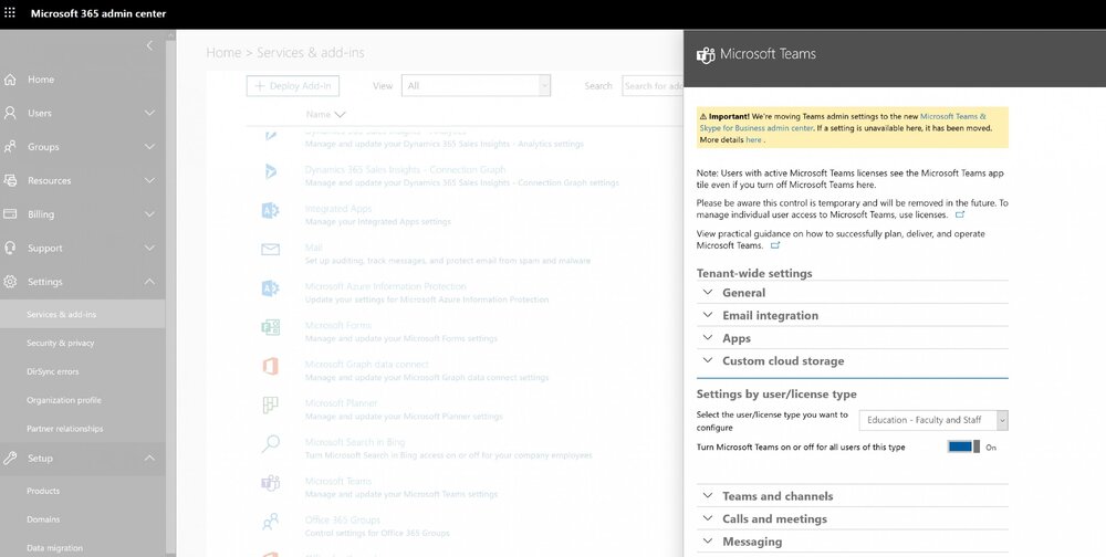

Hi - Stupidly there's a setting on the old admin console that might be tripping you out (That doesn't appear in the new admin console..)
See below - Make sure it's set to this
[ATTACH=CONFIG]58329[/ATTACH]

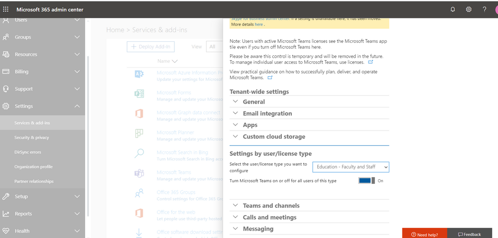

Yes you were right I couldn't see this however when I finally changed to other view my settings are exactly like on your picture.
[ATTACH=CONFIG]58330[/ATTACH]

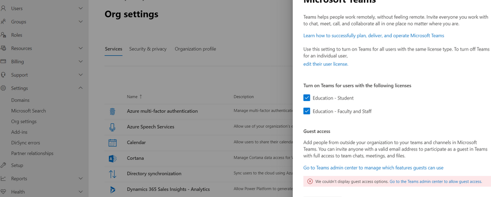

Also should Education - Student be on? I switch this on to see if it makes a difference.
