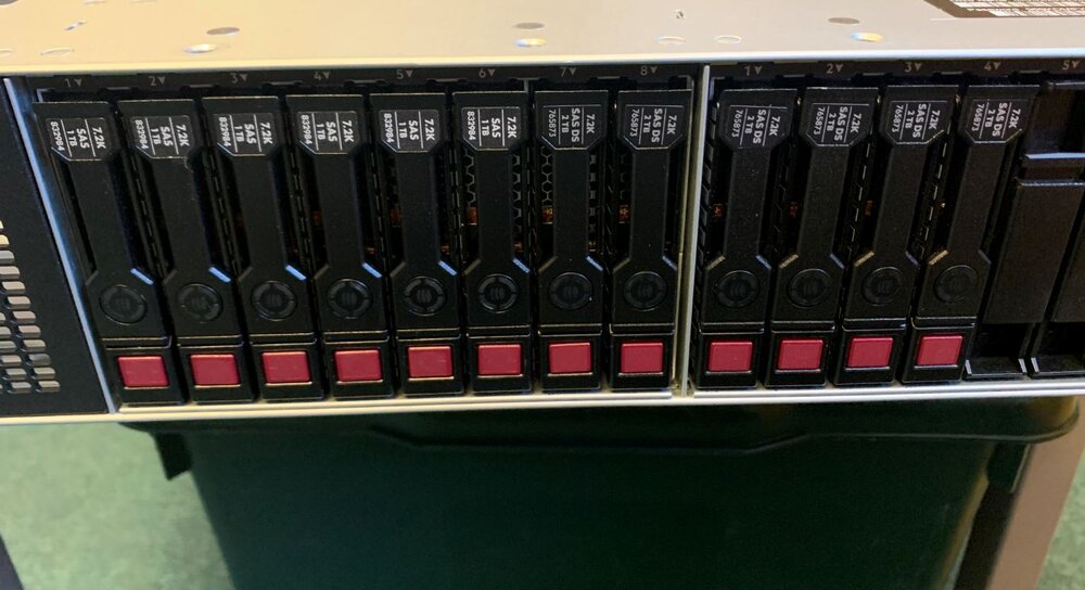

I have a new HP ProLiant DL380 Gen10 server which we are to use as a storage server.
It comes with 8 x 1TB 7.2k SAS drives and 4 x 7.2k 2TB drives.

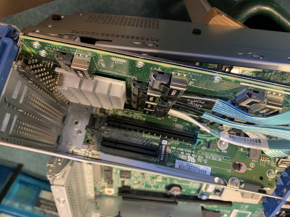

Hi, I am not too sure how I can check out which controller it comes with.
This is what it says on the warranty page:
HPE DL380 Gen10 4208 1P 16G 8SFF Svr
On the original order, it said:
DL 360 G10/Silver 4208/16gb/8 x 2.5 drives/P408i/50w/5yr warranty/6 x 1tb/6 x 2tb
Not sure if this helps, but all of the hard disks plug into a board in the PCI expander section of the server. This board has a sticker on it which says aec-83605/hp2. I notice it also has an M.2 hdd slot on it also.
Ok, looking at the spec sheet for that range of storage adapters here: https://h20195.www2.hpe.com/v2/getpdf.aspx/a00047736enw.pdf
The card can be run in both RAID and HBA modes so you can use Storage Spaces with Windows or ZFS with something like FreeNAS.

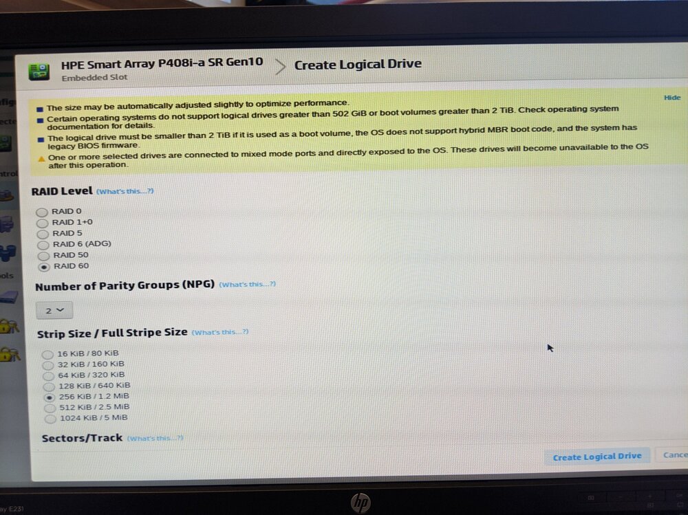

I have loaded up the RAID config screen, and am thinking of going for RAID 10 (Raid 1+0)
Does this seem best?
Edited by talksr

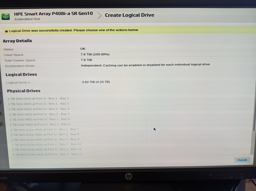

10 is usually the best to go for these days, mirrored and striped array. You lose half the storage, but gain redundancy and keep speed to a maximum, in terms of rebuild and access.
  • 2 months later...
Went for 10 and used the HP integrated storage software. Has been working a treat since. Thanks everyone for your input and help on this. I really appreciate it. :)
