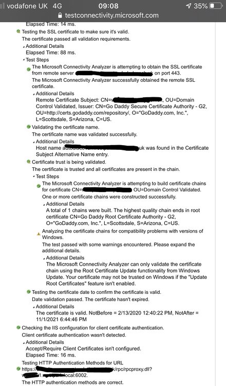

using the remote aconnectivity analyzer we are getting a succesful with warnings on both the connectivity and autodiscover, the only warning that it is moaning about is the ssl cert, which i belive is a common thing
when trying to create a migration endpoint mapper within office 365 (EAC) we keep getting an error around "We couldn't detect your server settings. Please enter them. The migration service failed to detect the migration endpoint using the Autodiscover service. Consider using the Exchange Remote Connectivity Analyzer ‎(https://testexchangeconnectivity.com)‎ to diagnose the connectivity issues."
however we know that from the test it is working, the RPC ports on the domain controllers are all open and i can telnet internally to them Port 6004, the exchange server which is visible to the world has the correct ports open, i have been on a phone call to sophos (2 Hours) and we are seeing traffic hit the firewall for the server however we cant be sure that its microsoft becasue there is alot but i have been on this website

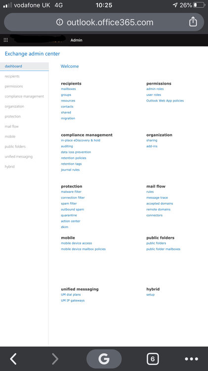

In in Exchange admin centre in O365, Recipients the Migration, Three dots, Migration Endpoints + then exchange remote, the rest should be obvious - what happens?
Well it moans about being unable to connect and also moans about the ssl cert but I think that is a common error the exchange test connectivity report says passes so it should connect not sure what could be stopping the connection
I’ve attached part of the rca report see what you make of it

Now the only problem is that I don’t have a servers tab in my office 365 eac
The EWS external URL setting and MRS enablement setting are done on prem, where you do have a server tab in EA​ Scrub that, just noticed you have Exchange 2007
