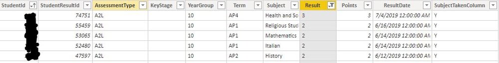

I have been tasked with a post-Assessment Point tracking sheet which on the surface sounds (and I think should be!) really straight forward, but when I have tried to create it I have struggled a little. I have attached a mockup of what I would like the sheet to look like. I have also attached a sample of how the assessment data is currently structured. What staff really want is to see, for their subject, which students are not on target at a particular AP and in conjunction with Attitude to Learning grades identify key students for interventions.
Mockup
Data Structure
My main questions I suppose are:
  • Having played around a little I think I am best using a Matrix visualisation for this? Would that be a good starting point? I was thinking Name, followed by Subject for the rows and Term for the Columns.
  • Am I right in thinking to get a matrix visualisation to work I would need to Pivot the Assessment Type column, using Result as the Values? This would, for example, give me a column for all of my different assessment types that I could add to the Values Column? So far so good and I can get it to work to a point and I can show Current TA and Attitude to Learning grades using this method.
  • The problem I have is getting my calculated column to work. The Target Grade is in its own term (TTG) so it doesn't show alongside the AP1 data, for example, and therefore a calculated difference column showing students who are on target TA - TTG, for example) will not work). I am not a fan of entering data against every term unnecessarily so wondered if anyone could see a way of manipulating the data so I could calculate each AP against a single target value
  • I would quite like to also also list students KS2 Banding. Again this is in a result set all on it's own. Even if we did copy this to all AP points, I would not really want it duplicating multiple times in the table as a matrix table would do.
Hopefully I have explained thoroughly enough that you can work out what I am trying to acheive but happy to explain further if anyone has some time to point me in the right direction. Please do tell me if I am going about this the wrong way, if I should be trying a different approach or giving up on PowerBI for this altogether.

HI @CyBeRkId2002
I feel your pain as (to the best of my knowledge) there isn't a great way to pivot some values in a matrix but not others. My preferred way round this (tho it involves a bit more legwork) is not to define a column value for the matrix, just a load of measures as values (each measure appearing once as a column in the matrix). This means you have to have separate measures for each of your assessment points.
If you go for CALCULATE(SELECTEDVALUE(,"#ERR"),[assessmenttype] = "Current",[term]="AP1") that will give you your current grade. The advantaged of using selected value is that it only returns a result if a single value is specified by the row/filter context (in this case these will be the student and subject from the matrix rows and the AT and term from the formula. If a kid has more than one current grade for a subject and term it will return #ERR.
You can use a similar measure to get target difference:
CALCULATE(SELECTEDVALUE(),[assessmenttype] = "Current",[term]="AP1") - CALCULATE(SELECTEDVALUE(,"#ERR"),[assessmenttype] = "target",[term]="TTG")
You'll want to add a check for missing targets/current grades though so add an if statement checking either measure for NULL values, return null (BLANK()) if yes, carry on with the calculation if no.:
IF(OR(ISBLANK(CALCULATE(SELECTEDVALUE(),[assessmenttype] = "Current",[term]="AP1"),ISBLANK(CALCULATE(SELECTEDVALUE(,"#ERR"),[assessmenttype] = "target",[term]="TTG")),
BLANK(),
CALCULATE(SELECTEDVALUE(),[assessmenttype] = "Current",[term]="AP1") - CALCULATE(SELECTEDVALUE(,"#ERR"),[assessmenttype] = "target",[term]="TTG"))

@RootsSchImp - Thanks for the thoroughly detailed response. It pretty much detailed exactly what I was wanting to achieve without knowing exactly how (I am slowly starting to get my head around when to use FILTER, when to use CALCULATE etc.)!
The data is looking far more like I am envisioning now.
The only problem I would still like to solve is how I can add filters to this so I can give staff the ability to just show an AP at a time rather than inundating them with data! Obviously each one of these results is now stored against each Term so adding columns and / or slicers will not work. What would be the best approach for this?
Once again thanks very much for all of your help oin this, it is really appreciated.
Happy to BI of service ;)
If you want to show just one AP and have it selected by slicer you can do that by replacing [term]="ap1" in your measure with [term]=selected value([term],"ap1")
Then if you have a slicer for [term] the measure will show the values for the selected term, with ap1 as the default if no term is selected.
If you want to get fancy you can replace "ap1" with calculate (selectedvalue(term),resultdate=max(resultdate)) which should make the default the term with the latest result.
If you make the clause a separate measure ('selectedterm') you can put that in the results measures (eg Term=[selectedterm] but also have it in a card to show staff which term's data is being displayed
