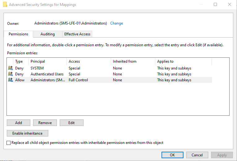

Well... Microsoft's 'fix' didn't work, issue came back again. What worked (tested for 3 weeks) was changing the permissions on the key.
HKEY_USERS\S-1-5-19\Software\Classes\Local Settings\Software\Microsoft\Windows\CurrentVersion\AppContainer\Mappings
First I deleted all the entries.

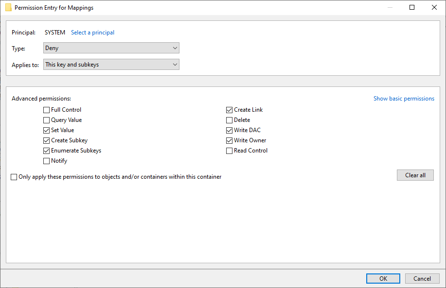

Then I turned off permission inheritance, removed all items. Added in Allow Administrators, which I gave full control. And I added in Deny SYSTEM and Deny Authenticated Users with the permissions below.
I also set a Group Policy Preference to Replace the Mappings registry key, so it would be reset regularly, just in case.
