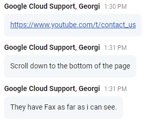

Since posting this I have posted on the YT communities forum. Someone suggested g suite settings but definitely not this. Also had 2 support chats with G Suite support to which they said "not our problem" and directed me to the non-existent youtube support. Glad you posted this as was just about to fire up a vanilla VM on the edge of our network to completely rule out filtering, chrome policies or group policies.

@bchiarmonte I have sent this with a screenshot via the feedback form as you have. Shows up how poor the youtube support is. There is a big accountability gap with who these issues lie with. Youtube support is impossible to contact and G Suite do not have the tools to help. It's like purgatory... hold on... this IS the bad place :)
