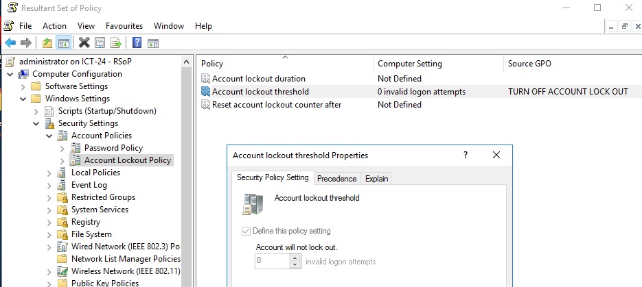

Koldov Posted March 20, 2019 Author Posted March 20, 2019 Well, that's annoying... Logging on to the machine and running RSoP shows that the setting was 'not defined' (but still locked me out). Tried my new 'NO LOCKOUT' policy and it has applied correctly (checked in RSoP). Logged out, logged in again with the wrong password 3 times and.... LOCKED OUT!!!!

Koldov Posted March 22, 2019 Author Posted March 22, 2019 (edited) Ok, so I fixed it at last.... Phew!!! Seems my Google-fu is on top form this morning (or I just worded my search terms a little better). It's still a little bit complicated to my mind, but here goes.... After a little searching I found this: https://www.experts-exchange.com/questions/24147612/Account-lockout-policy-is-still-being-enforced-after-policy-is-removed.html In that thread it mentions 'secpol.msc' - running that on an affected client machine showed the setting my new policy applied (even though it was being ignored - possibly because it was an OU level policy - see below*). However, running secpol.msc on the DC showed my old policy still being applied (on the DC) and yet looking at the 'Default Domain Policy' all settings were 'undefined'. I think I was on the right track in having to define it to change the setting, just that I needed to define it (as 0) back in the 'Default Domain Policy' and not try to override it with an OU policy. So after setting the 'Account Lockout Threshold' to '0' and setting it to defined in the 'Default Domain Policy' a quick 'gpupdate/force' later - no more lockouts! *As I also found that an 'account policy' change has to be made at the Domain level (or a policy linked to the root of the Domain), so trying to have different policies for different OUs may be slightly more complicated than I imagined, as @AJB123 mentioned I might have to look at fine-grained password policies... Edited March 22, 2019 by Koldov
