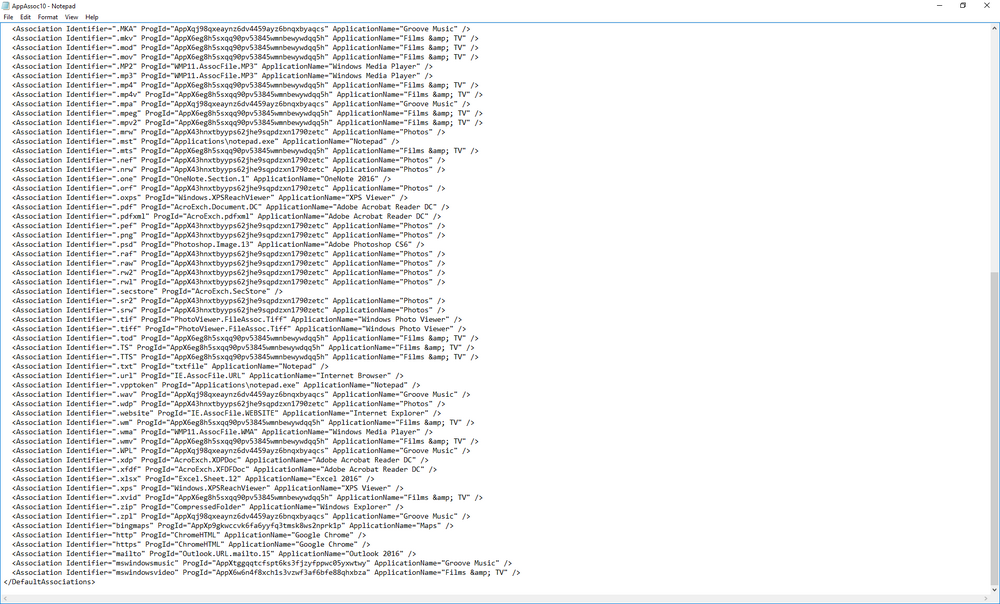

I am trying to set Adobe Reader as our default PDF viewer. Can anyone tell me how to do it?
I have a Default App Associations XML file.
I am not able to attach it, so have added a screenshot.
Thanks in advance. :)

Thanks, I already have it all set up on Group Policy, just wondering exactly what I need to do to get it to set Adobe Reader as the default as this is not happening with my current config xml file.
Change this line in your config file from Edge to Reader
Also read this TechNet Blog for the correct procedure.

I took a detailed look and it seems I already had that line in my xml:
But what I found was that in another GPO, I had another default file associations XML being linked. It was for Google Chrome so only listed HTML files.
I merged this into my main one and it all seems to be behaving its self now. It seems that the two separate GPOs both with differing default file associations must have been causing an issue.
