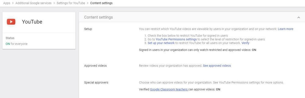

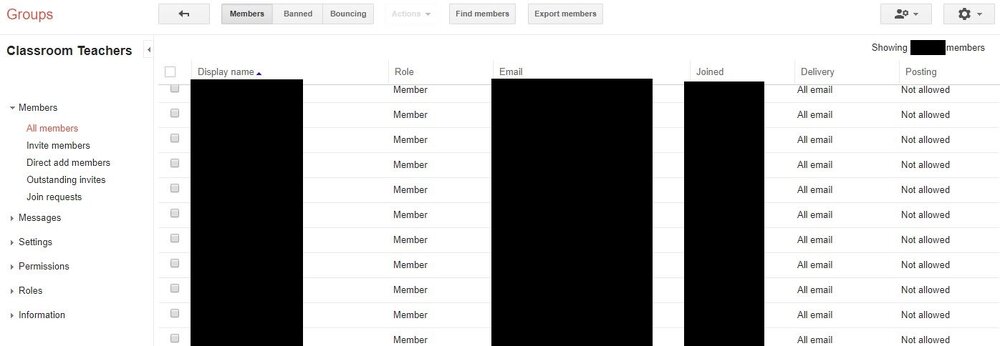

Sounds like you have DNS setup right. Are you using Google Apps for Education (or G-Suite, whatever they're calling it now)? If you are, the way it's supposed to work is all users have access to restricted mode; which is a specially curtailed white-list of kid friendly stuff. There is a lot of things that are friendly though that aren't in this list. Where Google Apps comes in is you can then give other accounts unrestricted access and the ability to add videos to that white-list for your domain. This access is given to your staff by making their accounts members is the 'classroom teachers' group (side note, this group also grants access to use Google Classroom). When a teacher browses videos not in your domain's white-list they'll be prompted right under the video as it plays to add it.
  1. Turn on 'Special approvers' in the conent settings for Youtube.
  2. Add teachers to the 'Classroom Teachers' group
  3. Let teachers know of there new found power and take one more thing off of your plate
Of course, if you don't have a Google Apps domain, then disregard this post in its entirety. :D
