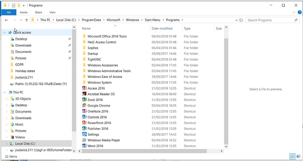

Have you got the tiles shortcuts in the local start menu folder on both machines?

It's program data/microsoft/windows/start menu or something along those lines. I'm not at my workstation right now. Check the shortcuts are present and call them in the XML file. Edited by Patrick
I found the directory and it all seems to be there, identical on each machine:
