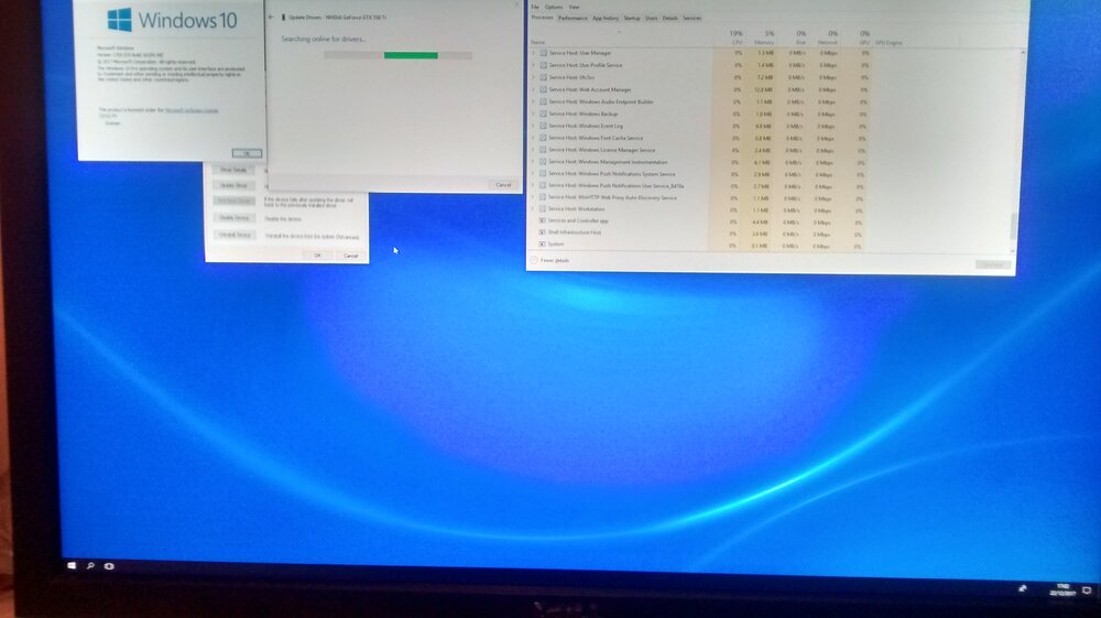

Just realised the background desktop looks as though it's come from Windows 7!!!
This is all very bizarre. And IE has just popped up. I think I tried to start it about 4 hours ago.
