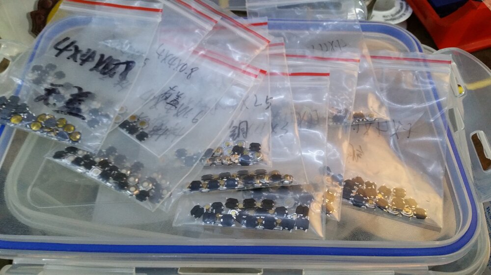

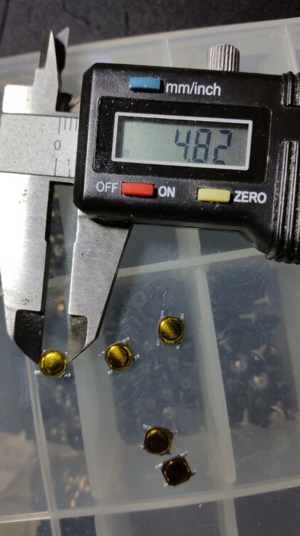

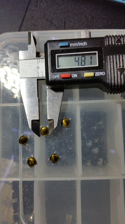

difinity Posted October 19, 2017 Posted October 19, 2017 I measure with digital calipers but they tend to be standard size. RS has some but I get mine for Aliexpress as they are much cheaper. Perhaps I could stick 5 in the post to you if they look to be the right size/style ? 2
Zourous Posted October 19, 2017 Author Posted October 19, 2017 Yes, from memory it is something close to 4mm. That would be very much appreicated if you could mail me some. I'll PM you my address.
