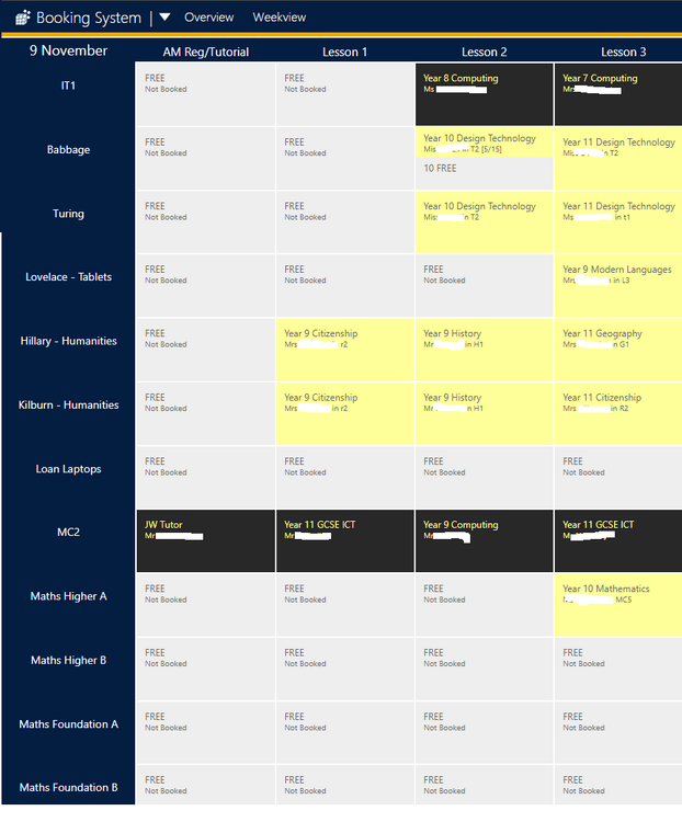

Slightly bizarre one, having added some resources (Maths Textbooks) to our booking system, when viewed on a screen that doesn't have enough space to show all rows as you scroll down the rows end up out of alignment with their Resource/Room name - MC2 is the row of black fixed bookings on the screenshot and the resource booked in E6 in the second visible lesson is Maths Foundation B

Hi @DPenfold, thanks for the idea, a double booking would push it off the right side, not misaligned the bottom, attached is it shown on a screen with larger resolution:
and for clarity the whole page is much bigger:
it is only since we added the 4 Maths Resources that we have really noticed the issue, although it actually appears with less resources, just is less noticeable.
It is almost as if the rows for the headings are not in the same table as the rows of bookings, so they slip when display resolution is too low, but my code skills are not good enough to work out why.

An update for anyone else having this problem or coming across this:
With a bit of help from a friend we have changed this line:
#bookingday .body .col, #bookingday #resources div { height: <%=Math.Round(110.00 / (rez.Count + 1), 1) %>%; }
to this
#bookingday .body .col, #bookingday #resources div { height:5em; }
in HAP\BookingSystem\Default.aspx
which has resolved the issue for us. :)
