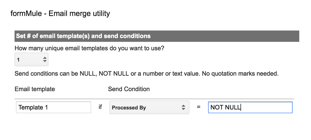

Hello,
I have it running, its just the conditions stuff. I am not 100% sure. I have a column called processed by. If they is empty I don't want the merge to be triggered.
Would it be like the attached please?
Thanks
