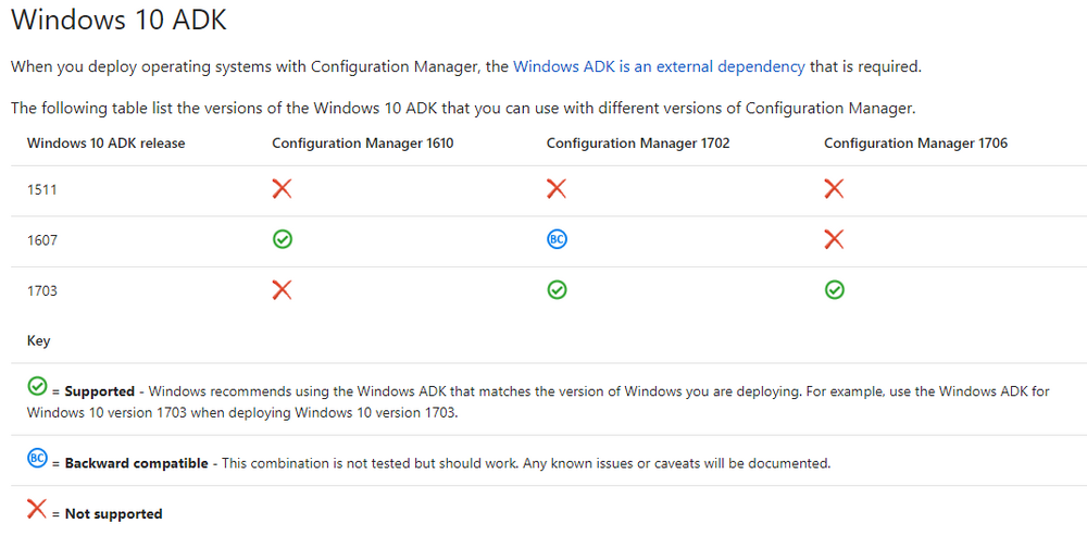

  • SCCM will now be updated along with the release of new Windows 10 builds. This means that you will also need to update to the ADK released with the new Win 10 build and possibly MDT (though this won't be updated for every build, just as needed). Although its not strictly necessary to have everything aligned like this, it is recommended. There is however a handy chart of supported configurations here
  • You can find the latest ADK here: https://developer.microsoft.com/en-us/windows/hardware/windows-assessment-deployment-kit

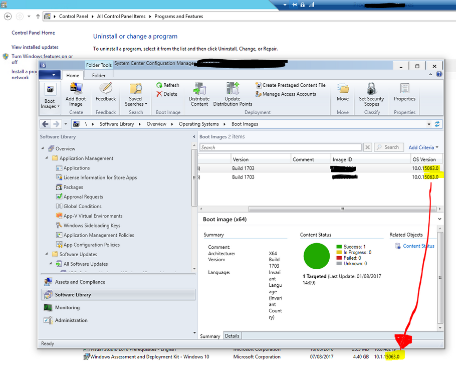

  • Update ADK first! When you update SCCM it will generate new boot disks. If you have already updated ADK then you will get updated boot disks based on the new ADK. If you don't then you get boot disks based on the old ADK. You can check if you have the latest boot disks by comparing the version of the boot disks in SCCM to the version of ADK in add/remove programs:
  • If you do update SCCM first you can regenerate the boot disks to be based on the update ADK with this handy script: https://gallery.technet.microsoft.com/RegenerateBootImageWinPE10-f508f1e4
  • After this you can update SCCM from the console
