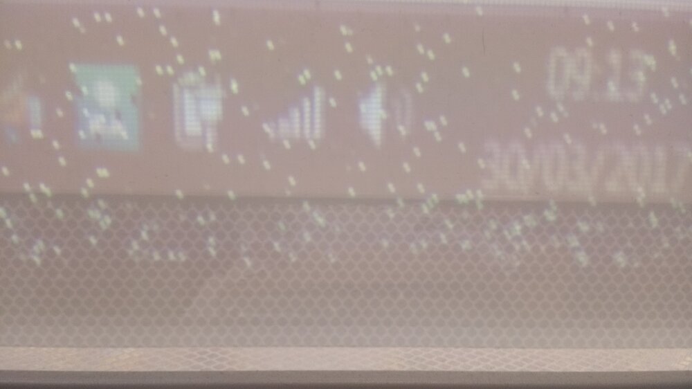

As the appalling picture above just about shows I've got a SMART board with, what I think are, stuck pixels around the right hand side and top and bottom right of it. They remain on the board when I disconnect the client machine, leaving the projector on. I've tried disconnecting and reconnecting the projector with no effect. The bulb was replaced in November.
Board : SMART SBX880
Projector : NEC U250X
Can anyone advise of a fix?
Many thanks
Simon
This happened with a couple of promethean projectors here. I got told there is nothing you can do and it's a new projector.
Although part of me thinks you could swap out a part inside... that little 3 screen colour split block... but I'm not sure how difficult that would be. It would cost more to repair if you sent it off than to replace it.
Thank you for your replies. Yeah, I think the projector is out of warranty. Not sure I'm brave enough to go tinkering with the projector internals.
I had a similar issue with one of our NEC projector and it was under warranty - the engineer just cleaned reflector just behind the lamp...
Thank you, I'll give that a go.
