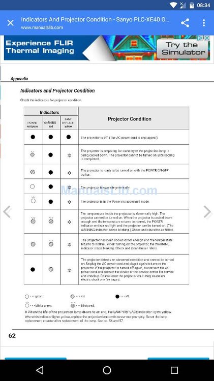

I'm having the same problem that many people wrote here. The projector turns on, and then after three attemps and no light it turns off, I checked the thermal and it was on, I cleaned everything, and nothing, do you think that is it a lamp?
all the best and please help me on this :(
Nothing :(!
- i plug the AC cable and the power Led turns RED
- with the controller I power it on and the power Led turns GREEN
- the fans start, I kind of feel 2/3 attempts (an attempt is a powerful workings sound followed by a smoother working sound)
- and then the power Led turns into a FLASHING RED and after a powerful working of the fans the projector turns off, and the power Led stays RED but not flashing
