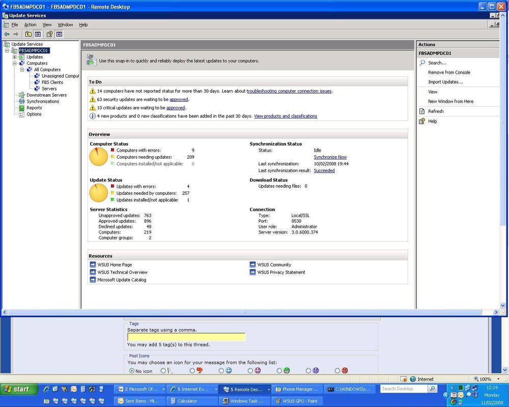

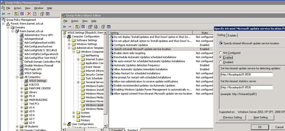

z4ydi Posted February 11, 2008 Report Posted February 11, 2008 I have installed WSUS ver 3.0.6 on one of the servers which is not on the domain (on workgroup), but it has 2 NICs (for curriculum network and one for Admin network), I have configured a GPO on the Curriculum Domain controller to point clients to the WSUS server. the WSUS sees all of the PCs from both domains, but for some reasons the GPOs don't get applied on the clients (hence no updates are picked up). please let me know how to deal with this. thanks

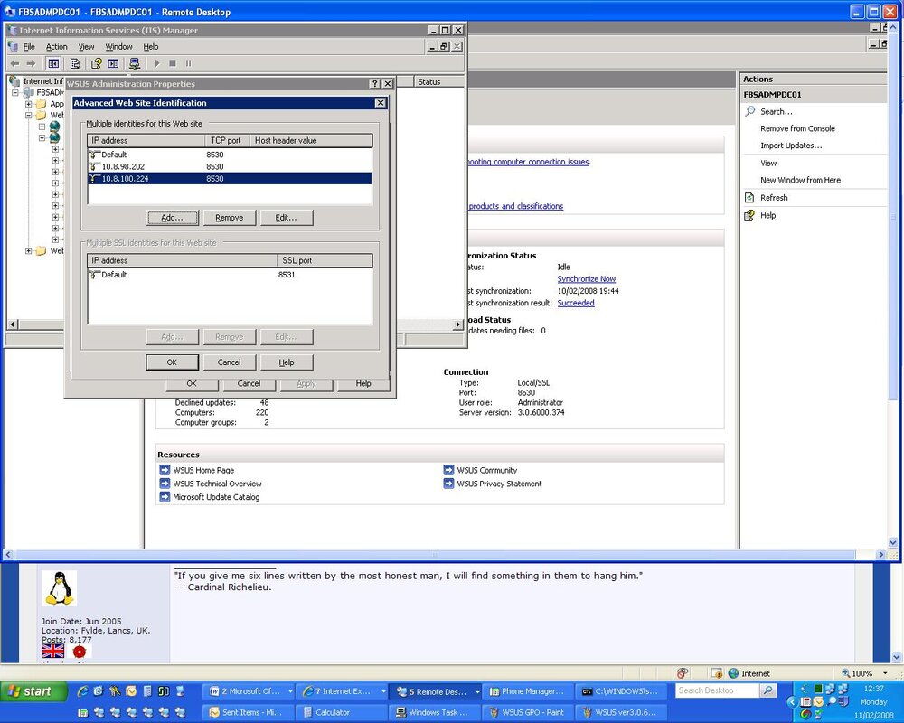

Geoff Posted February 11, 2008 Report Posted February 11, 2008 Have told IIS to listen for connections on both IP addresses?

z4ydi Posted February 11, 2008 Author Report Posted February 11, 2008 Have told IIS to listen for connections on both IP addresses? I have not specified any IP addresses, but I just went to IIS and did the following . could you please check if I done this correctly for the 2 IP ranges.
SYNACK Posted February 11, 2008 Report Posted February 11, 2008 I have not specified any IP addresses, but I just went to IIS and did the following [ATTACH]1321[/ATTACH]. could you please check if I done this correctly for the 2 IP ranges. Looks right to me, I would try it on the standard port 80 if possible as I never got WSUS working on a non-standard port via group policy. It was an older version, but I think that the problem may have been on the Windows side rather than the WSUS server side.

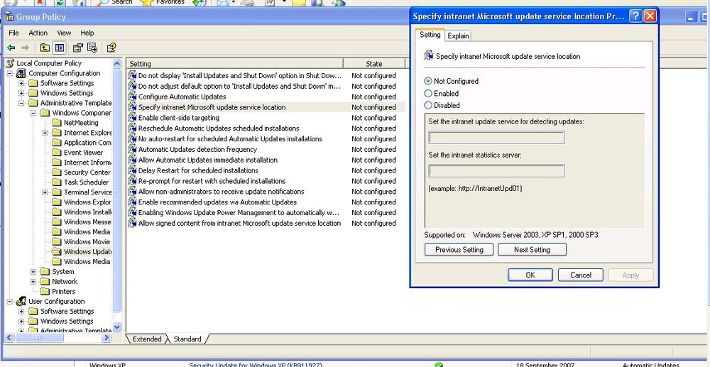

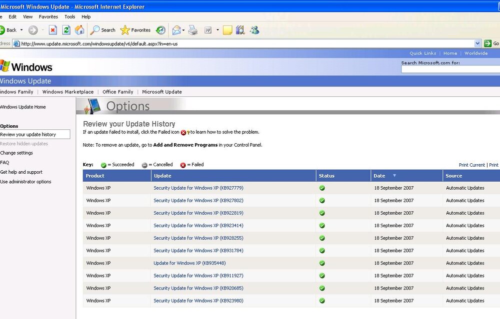

z4ydi Posted February 11, 2008 Author Report Posted February 11, 2008 I have checked the update history of some of client PCs they have not picked anything up since Sep 2007, I think the problem is the GPOs because when I check the client Local GPO they dont seem to be picking anythingup from the server GPO
