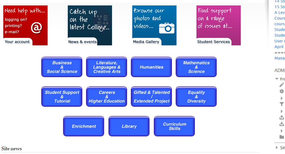

In case you're not aware this is not theme dependent. You can add any graphics to serve as links on the front page once you've altered the following front page setting:
Go to site admin>front page>front page settings and tick "enable a topic section"
This gives you a topic section on the front page to place your images (perhaps inside a 'label').
