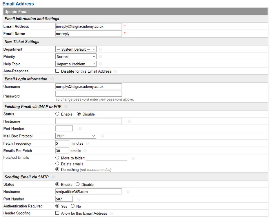

chrispounds Posted May 25, 2016 Author Report Posted May 25, 2016 I'm just evaluating osticket and struggling to get SMTP to work. My settings are as follows; Hostname: smtp.office365.com Port #: 587 Authentication Required: yes I get the following error; Could you confirm the exact settings used @chrispounds Hi Nathan, Sure, my settings are as follows, all i had to make sure was that the e-mail information was correct and the account existed withing 365. 1

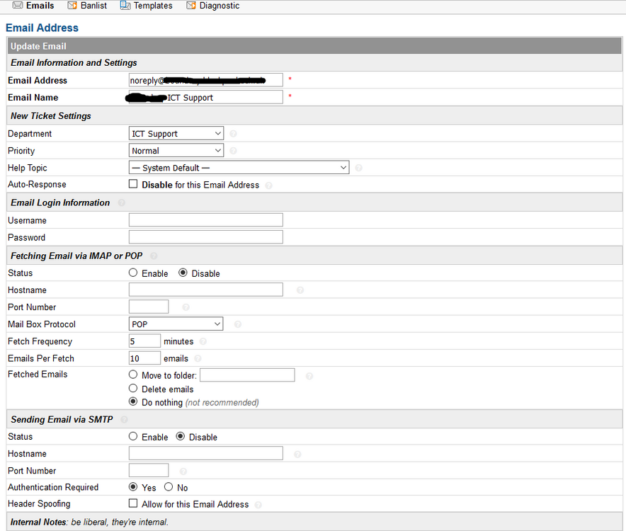

nathan Posted May 25, 2016 Report Posted May 25, 2016 scrap that, i had disabled SMTP in the osticket settings. thats why it tested them asok when saving the settings - not my finest hour (is it time to go home yet?) i continue to get the same error despite having the same settings as above.
chrispounds Posted May 26, 2016 Author Report Posted May 26, 2016 Can you post a grab of your settings? Strange that it isn't working, nothing on your firewall blocking the port traffic?

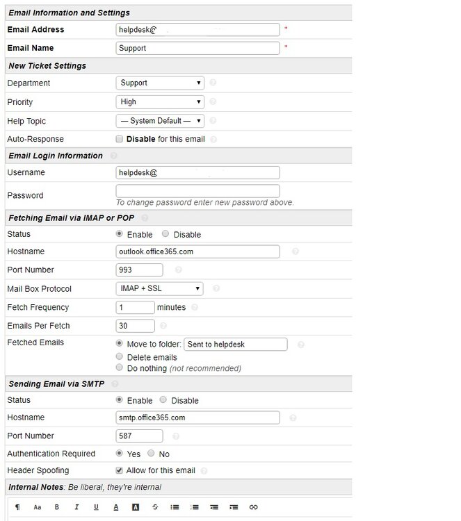

synaesthesia Posted January 5, 2018 Report Posted January 5, 2018 Yes it's enabled, these are our settings:
wickedweasal Posted January 5, 2018 Report Posted January 5, 2018 very odd my settings are exactly the same as yours but I still get the error when saving the settings, I guess I will have to check my office365 configuiration and see if that is where the problem lies. @synaesthesia thanks for providing your settings though.
