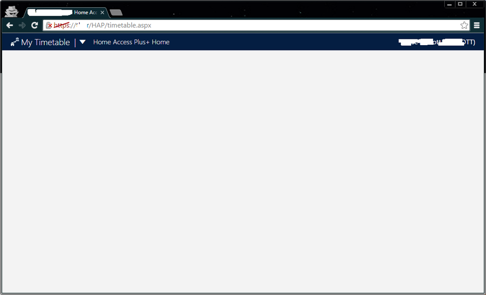

Hi, I have a problem with the timetable plugin
It has imported from SIMS (I can see it all in the AppData\Timetables)
If as an admin I try and impersonate as user or UPN I get nothing, a student user with the UPN in their Employee ID field also gets the same
Any suggestions greatly appreciated.

Hi,
From the looks of the screenshot that you originally posted, it looks like a resource isn't loading properly. As you're using Chrome, try opening the developer tools (Ctrl + Shift + I) and swap to the network tab, then refresh the page (alternate browser steps here: http://www.edugeek.net/forums/home-access-plus/86059-hap-json-debugging.html)
See if there are any resources being shown in red, which are ones that have not loaded properly. If you click on one, it should let you see any HTML response from the HAP+ server, which may give you some more information.
The console tab in the developer tools may also tell you if there's an error, along with what may be causing it.
Spot on Stuajnht,
afterhap?/HAP/api/js/afterhap?/HAP/timetable.aspx=10.5.1014.1930 returns a 500 Internal Server Error and no Response, but I have no idea why!
