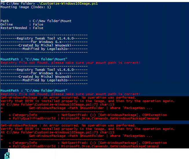

I am getting a few errors. I was wondering if you can help please?
Are you running the script on a Windows 10 PC?
Which install.wim are you using? One you have captured previously or an unmodified .wim from a Windows 10 ISO? It's best to use the latter.
Also, which edition (Pro, Education, Enterprise etc.)?
Edited by Arthur
I am running it from a Windows 10 PC. The WIM is captured from a Windows 10 PC. I have never modified it before. It is Windows 10 Enterprise LTSB.
Thanks
Just tried it with the WIM from the DVD media, same thing
I'll do a bit more testing later with an LTSB image to see if I can replicate the issue. My script worked fine with the Education edition. :)
