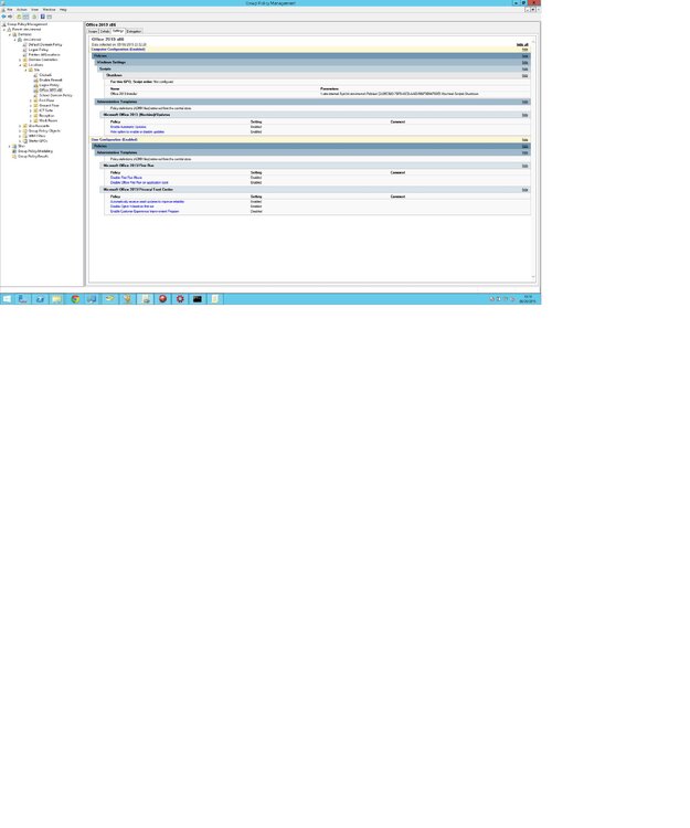

Well spotted, but strangely this batch script still works even with the spaces when it is run manually.
I have changed this but still the computers are not installing. Have tried the usual gpupdate /force. Checked gpresult and the policy is showing there so I know it is picking it up. Can't find anything in the logs to help me.

I think you may have solved the problem. The gaps in the batch scrip you unearthed were also present in the xml document. The space was also present in the actual directory. I have sorted it, doubt it would have caused an issue as all references to that path had "" around them which should cope with a space. I have changed the GP from a Shutdown script to a Startup and it is now working perfectly!
