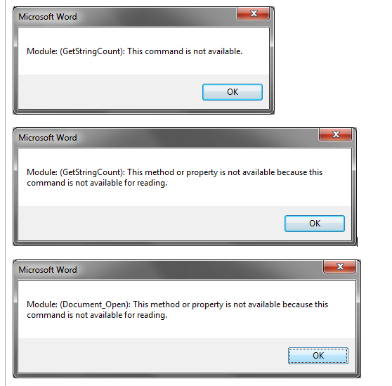

Great - this doesn't seem to work for WORD 2013, though - is this what you use it with?

I've not been upgraded to 2013 yet, but a quick Google suggests the issue is with Reading View. Two options; open Word, go in to Options and look for a checkbox labelled "Open e-mail attachments and other uneditable files in reading view" - uncheck it.
Of, try this (untested) version of the script:

@LosOjos I've got this working with your latest revised script, thanks!
