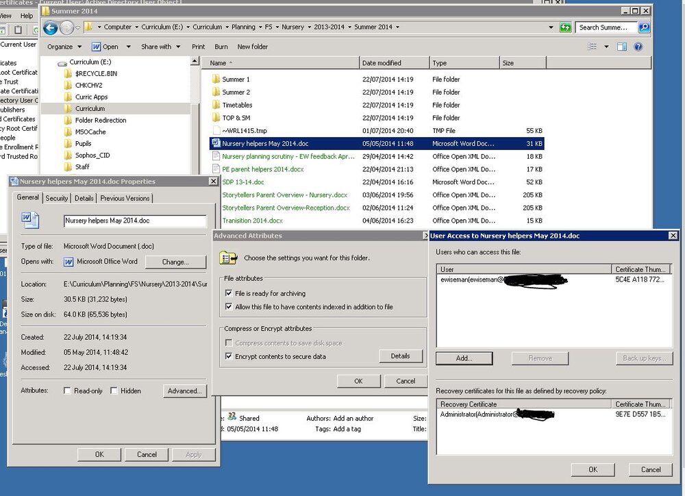

It seems that a user had encrypted files on their laptop, which they helpfully copied to the server when they left. However the client machine has been re-imaged and the AD account deleted.
When I look at the file details (Properties\Advanced\Encryption Details) I can see that there is a recovery certificate.....but I have no idea how to use it. Please help! (I know I sound like a user!) Screen shot attached.

I've found a copy of the user's certificate on the server, but when I exported it, it didn't give me the option to export the private keys. Is the recovery certificate (shown in the attached picture) not the one I need?

Is the account listed under the recovery certificate the domain administrator account?
If so - you should be able to un-encrypt the files whilst logged on as that user.
The account name is shown as "administrator@domain" which is not the domain admin account.
When I log on as domain admin, I still can't open the documents.
I presume it's also not the local admin account from the client, as that account name would be "administrator@machine_name"?

Literally administrator@domain? or administrator@The-name-of-your-domain
Sorry - unclear.
It's: administrator@our-domain-name

Making progress now: I've logged in as main domain admin account, installed/enabled "certificates" snap-in and under certificates/current user/personal/certificates there is a certificate issued to "Administrator" which states it's purpose as "file recovery". Now I just need to work out how to use it...

Logged in as the first domain admin account on the only DC in the domain, the certificate console snap-in shows the current user having the certificate matching the one listed on the file properties as the Recovery Certificate. Certificate shows as valid from the date the server was installed through to 100 years later, so should be valid for the date the file was created/modified/encrypted. I can now remove the tick (progress from yesterday), but when I press Apply, I get a prompt saying that you need provide administrator permission to proceed. When I click OK, I get an Error applying attributes" message, with the description Access is denied. No further password is requested - presumably because I'm already logged in with the highest authority possible.
