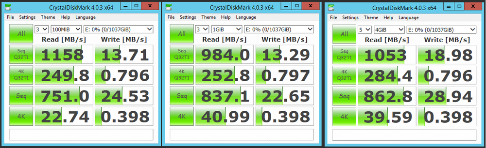

Just to wet you're appetite here's what a tiered storage spaces test server (2009 model) looks like with 2 x cheapo SanDisk ssd and 4 x 10K SAS drives.
Right, so I've just managed to get our test server up and running with tiered storage - 2 x 128GB Kingston SSDs and 4 x 500GB 2.5" drives taken from laptops during upgrades, so not the most "enterprise" of drives. CrystalDiskMark gives:
This compares with our current productions servers, Dell machines with RAID cards with 1GB of cache RAM each:
And, for comparison, AButters' results for tiered storage from earlier in this thread:
Write speed on our array is rather poor. Thinking through why this is, I'm wondering if the benchmark is actually mesuring the correct thing. This is tierd storage, the SSD is not acting as a cache, so when (random, benchmark-generated) data is written it is written straight to the crusty, slow second-hand harddrives. Windows would only move that data to the SSD tier if it figured it was often used, which it isn't going to be with a synthetic benchmark. The figures above are telling me that SSD read speed is okay, which is nice, and that the other harddrives are slow, which I know already.

Is write caching enabled for the drives in Windows?
Good point. For each individual drive, in Windows (set via the "Policies" tab for each harddrive from Device Manager), no. For the Microsoft Storage Space Device constructed from a composite of those individual disks, yes.
For the HP P420i RAID controller, for individual disks (well, individual 1-drive-sized disk arrays), no. I can change that via HP Smart Storage Administrator by setting the Physical Drive Write Cache State - new results:
That seems to even the figures out somewhat, although the stated read performance seems to have around about halved in some cases.
I think the issue is that this benchmark isn't testing what Storage Spaces actually does. I'll try a script that copies some files around, see if I can better make it mirror an actual workload.
Edited by dhicks
