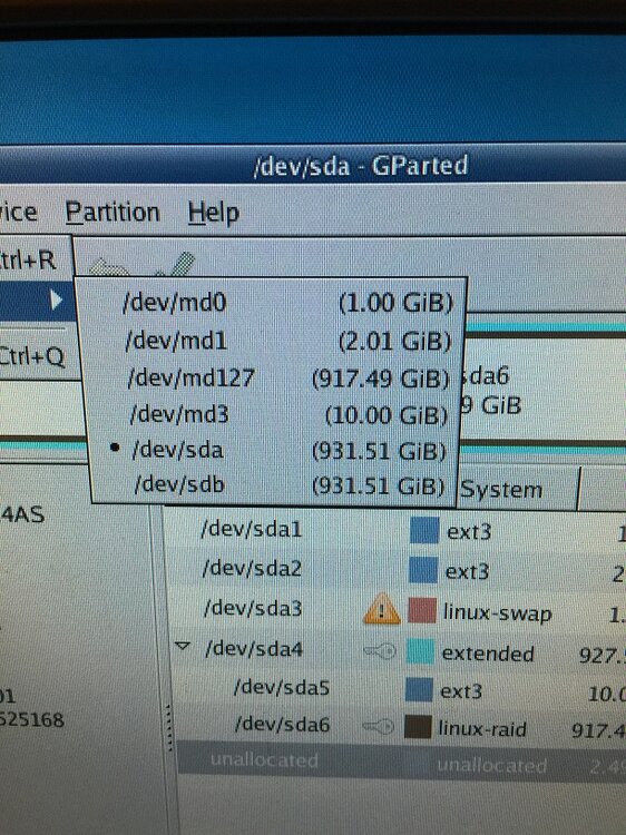

Well it's showing the drives which is a better start :p
Looks like dual drives that are pretty much just one virtual array.
@Geoff Is that likely to mean I'm gonna need to effectively have space for all 6 drives on P2V image? Or any idea how that would work lol :)
Thanks,
Steve
If you can get to grub, try booting in single user mode (add 'single' to the end of the boot command line)
You have two 1TB physical drives. Each has a swap partition and 4 raid volumes. It looks like your data is actually on an LVM volume on the Software RAID. If you can establish which is the root partition (I'm guessing the 900+GB LVM partition) you can mount and boot SystemRescueCD and change the root password.
As far as P2V, you'd need 2 x 1TB virtual disks as that's what you physically have.
