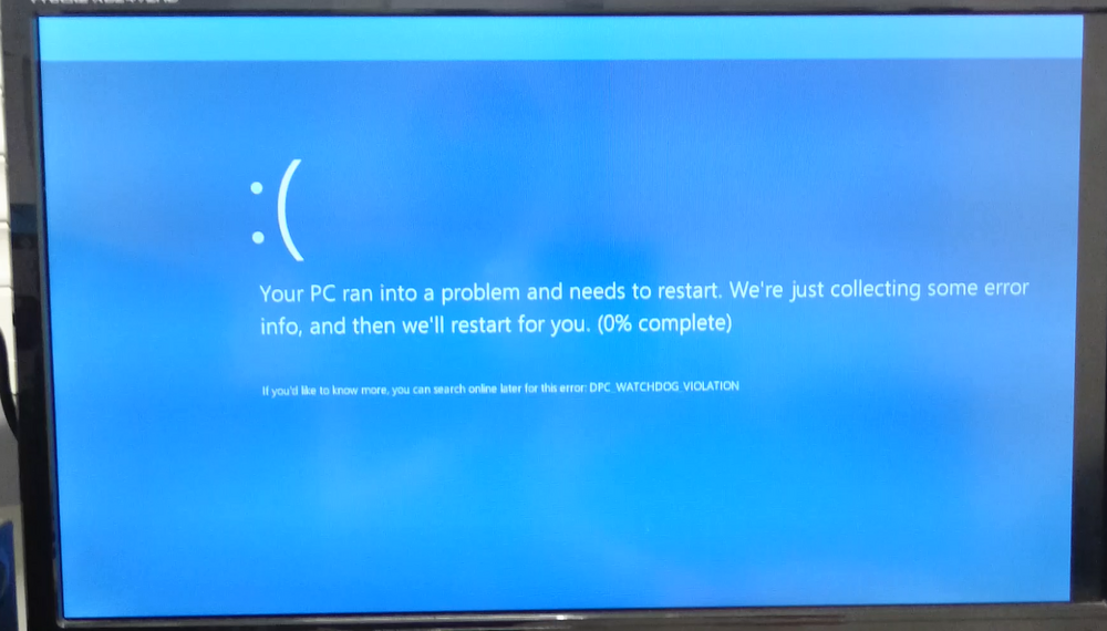

mcoyne Posted March 25, 2015 Author Posted March 25, 2015 Right then, here's an update... I tried using the memory stick boot method on the troublesome HPs, and although the problem persists, it actually provided a bit more information in the form of the attached error message. I now have something more specific to Google! And suggestions welcome, but I think I am going to try switching between UEFI and Legacy mode in the BIOS, possible looking at a BIOS upgrade, possibly injecting the latest HP drivers and seeing if any of that makes any difference. I'm certainly learning a lot in the process! Baptism of fire with this one.

korifugi Posted March 25, 2015 Posted March 25, 2015 (edited) Ooh - a Win8 BSOD, looks like it may not like something you're putting in there. Legacy mode will help - for some reason UEFI can do weird things with OS deployment. Also - if you're only trying to deploy one type of image (as in only x86), then it may be a good idea to ONLY inject the x86 drivers, I've had a machine in the past try to pick up x64 drivers for an x86 build. Le Edit: When it complained of no Network Drivers - did it give a PnP_ID? Edited March 25, 2015 by korifugi 1
mcoyne Posted March 25, 2015 Author Posted March 25, 2015 Hi Korifugi and all, Well, you won't believe it - a combination of re-injecting the drivers and running in legacy mode has done the trick, and I now have a HP machine happily taking an image! SO HAPPY! Don't understand why it's a Win 8 style BSOD I was getting before, as we're not deploying Win 8 but oh well, it's working! Thank you for the advice re x64 bit driver - that would have been my next thing to try as some are in there, and we are just deploying x86 at the moment. Thanks everyone for your help! Michael
themightymrp Posted March 25, 2015 Posted March 25, 2015 If you have MDT 2013 with the Windows 8.1 ADK on the server then the WinPE environment is Windows 8 based, hence that screen. 1
