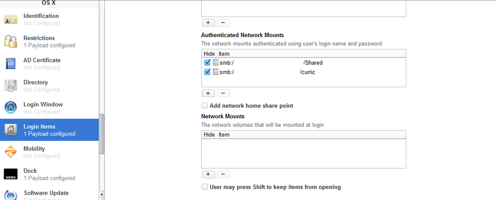

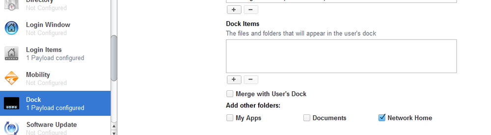

Hi, Thanks for tips. Have all that activated. Can you send me some screen shots of your profile manager setup. 1 from the dock settings and 1 from the login settings. If I put a tick in 'put homefolder on startup disk' then the
network home folder maps correctly to the dock but as soon as I take it out it goes.

When you use the "Use UNC path to derive network home location" checkbox in Directory Utility it puts the top level share on the desktop and the users network home in the Dock. This is a feature of the AD plugin in directory utility. When the user logs in the Dock icon often shows as a ?. This is a known bug that has been around since 10.3 I'm afraid. We work around this by unchecking the "Use UNC path..." checkbox and using a login script to mount the drive. We don't often add the icon to the Dock but if we do need to we use dockutil in a script.
For shared network drives, if you are deploying via Profile Manager, this will only add them to the desktop as its a different process to the mounting of the user home via directory utility. If you wanted them added to the dock you would have to use a dock config profile in profile manager or a dockutil script.

we just map homedrive at login with no scripts, just the default mac set up at AD bind and then set a MCX redirect to create an alias on the users desktop. works a treat.
