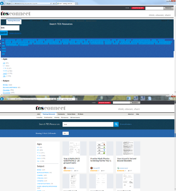

Garacesh Posted February 9, 2015 Posted February 9, 2015 Assistant head has been trying to get some resources from TES, but the resources search page doesn't render properly. Oddly, it works fine if he tries it on his iPad, and if I try it from my user. But from his account (and our test staff account) it doesn't work. Primarily, it's not being blocked by Smoothwall, which was our first port of call. So I thought maybe security settings (we can edit ours, staff is set by policy). Both Security settings and the Advanced settings are identical (with the exception of Do-Not-Track) Kind of at a loss here of where to go. Top: How it appears for Staff Bottom: How it appears for me (and on his iPad)

Garacesh Posted February 16, 2015 Author Posted February 16, 2015 (edited) Well using FireBug (handy! Will keep that one for further use) everything is either *.tes.co.uk or *.cloudfront.net which are both unblocked.. With the exception of one query to each of the following: https://secure-uk.imrworldwide.com/gibberish and https://tsleducation.112.2o7.net/gibberish which are both giving me untrusted connection if I try and navigate to them 'normally' (Specifically: The certificate is not trusted because no issuer chain was provided. (Error code: sec_error_unknown_issuer)) Edited February 16, 2015 by Garacesh
Opendium_Steve Posted February 16, 2015 Posted February 16, 2015 The certificate chain on both of those looks fine to me: Certificate chain 0 s:/serialNumber=8zNjMBehFD3Tbe0sezmihZ-h-hfwCArp/OU=GT17759042/OU=See http://www.rapidssl.com/resources/cps ©13/O U=Domain Control Validated - RapidSSL®/CN=*.imrworldwide.com i:/C=US/O=GeoTrust, Inc./CN=RapidSSL CA 1 s:/C=US/O=GeoTrust Inc./CN=GeoTrust Global CA i:/C=US/O=Equifax/OU=Equifax Secure Certificate Authority 2 s:/C=US/O=GeoTrust, Inc./CN=RapidSSL CA i:/C=US/O=GeoTrust Inc./CN=GeoTrust Global CA and: Certificate chain 0 s:/C=US/ST=California/L=San Jose/O=Adobe Systems Incorporated/OU=Adobe Marketing Cloud/CN=*.112.2o7.net i:/C=US/O=DigiCert Inc/OU=www.digicert.com/CN=DigiCert High Assurance CA-3 1 s:/C=US/O=DigiCert Inc/OU=www.digicert.com/CN=DigiCert High Assurance CA-3 i:/C=US/O=DigiCert Inc/OU=www.digicert.com/CN=DigiCert High Assurance EV Root CA My guess would be that your Smoothwall doesn't think the certificate chain is valid when it does its HTTPS interception - maybe its root certificates are out of date - I assume all other https sites work fine without the browser showing certificate warnings? imrworldwide.com is registered to The Nielsen Company (no idea who they are), 2o7.net appears to be owned by Adobe. I guess you could try whitelisting those so they don't get decrypted by the Smoothwall.
