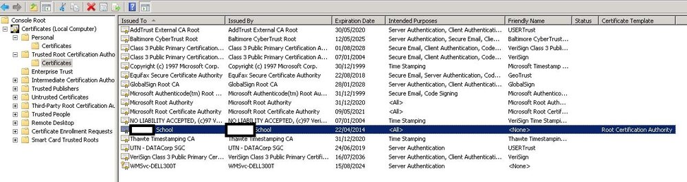

I upgraded our DC from 2003 to 2008 during summer (32bit, getting replaced next summer) and since then I've been getting CertificateServicesClient-AutoEnrollment errors in the Event Log (Event ID 64) with the following text: Certificate for local system with Thumbprint [40 digit hex thumbprint] is about to expire or already expired.. I followed the instructions to resolve the error here: Event ID 64 — AD CS Certification Authority Certificate and Chain Validation and found that the certificate in question had expired over 3 years ago:
